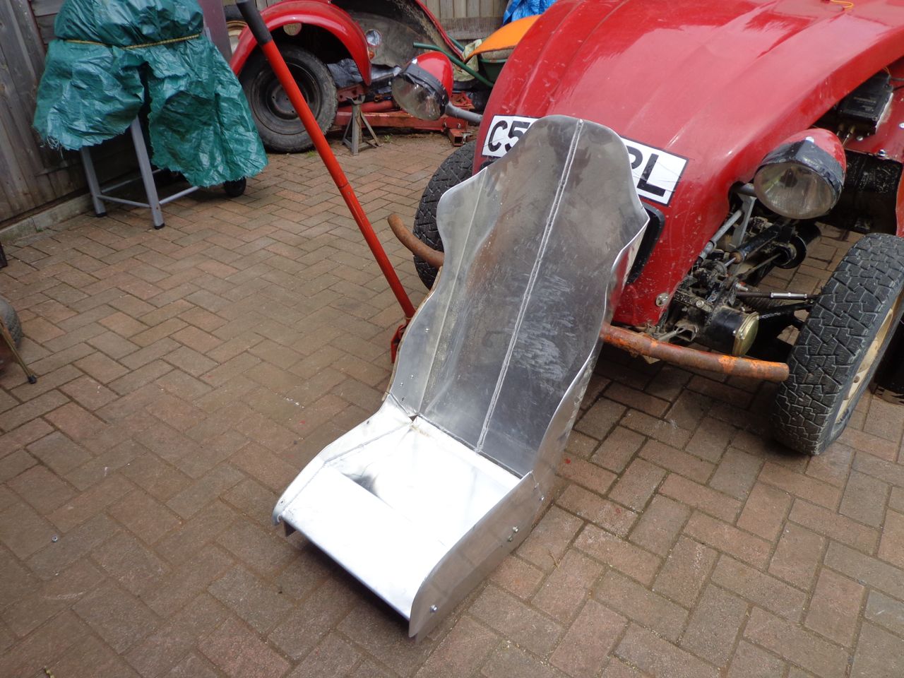

Passengers mentioned that the seat moved a bit.... now fixed frame with four nuts and bolts... replacing 2 bolts, 1 nut and a block of fire wood...

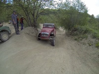

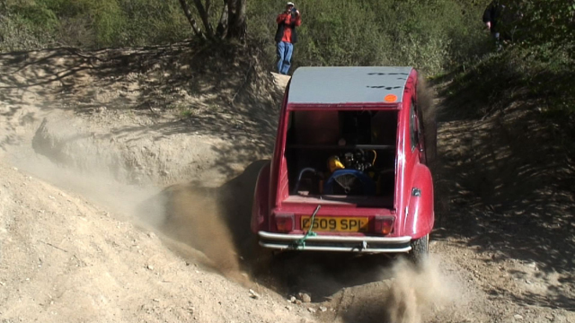

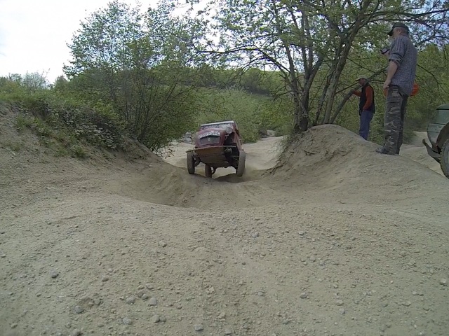

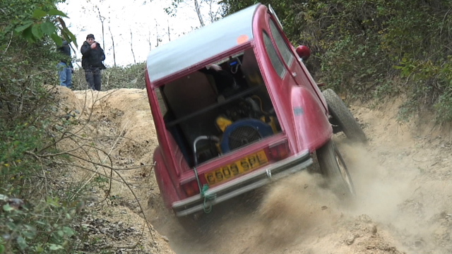

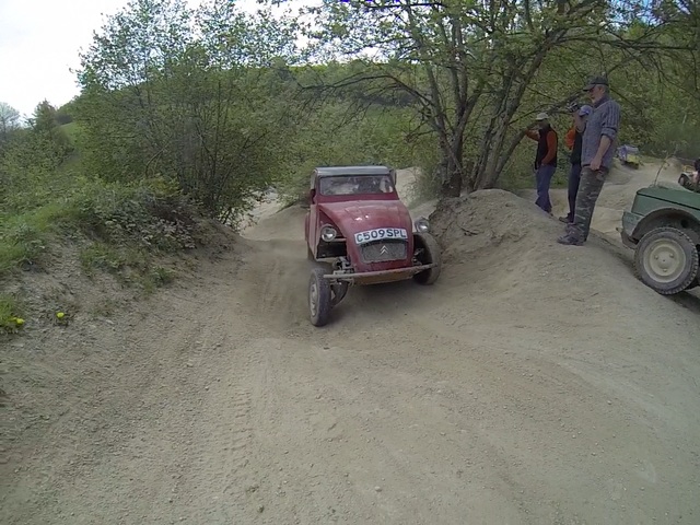

A few stills of Pete's car from my Morvan footage...
http://www.studioru.co.uk

Thanks Ru, looking forward to the Morvan video...

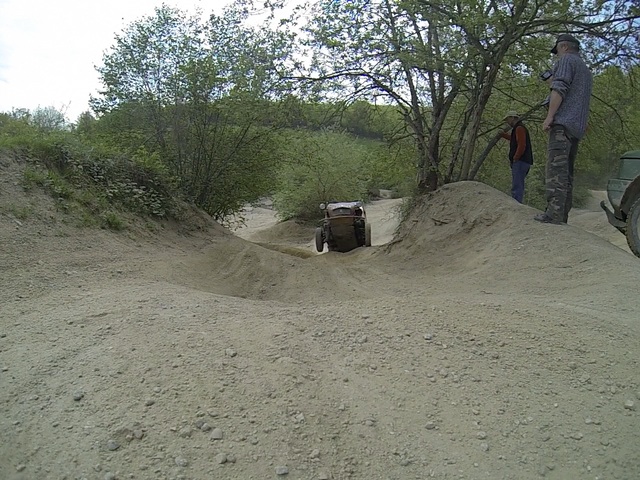

This.......
reminds me at this
ok. no wings on in but apart from that... :D :D :D :D :D :D :D :D
