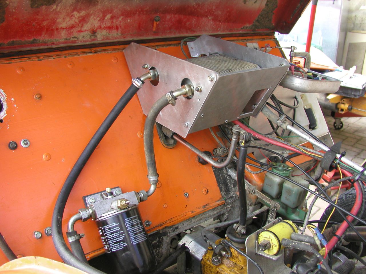

Do you have to have a fireproof bulk head between the engine and seats etc?? Nice work :)

@chris This is the biggest item to do, firewall is harder to do as the divide is halfway along the rear doors, an engine cover may be easier? But then it will over heat! Ideas welcome...

Remove the back windows in the rear doors and replace with alu and then large feed tubes down to the engine box. :?: :?: Maybe

I like Chris's idea of an intake in the rear door feeding the engine cover.
Another nice idea would be an aluminium roof scoop which acts as a snorkel to feed the inlet.
I can see you are correct in the engine cover being the biggest item to do. Using separate ducting for inlet and cooling will bring the best gains for keeping you, motor and inlet cool... Then you have to make it submersible :evil:

Why has nobody suggested opening up that vent flap which Pete has glued shut?
Then prop the boot lid open a bit... :roll:

Plus a square oil cooler maybe from a Freelander with SPAL fan mounted on it......

@Plus a square oil cooler maybe from a Freelander with SPAL fan mounted on it
Got some of the parts from the previous set up.
