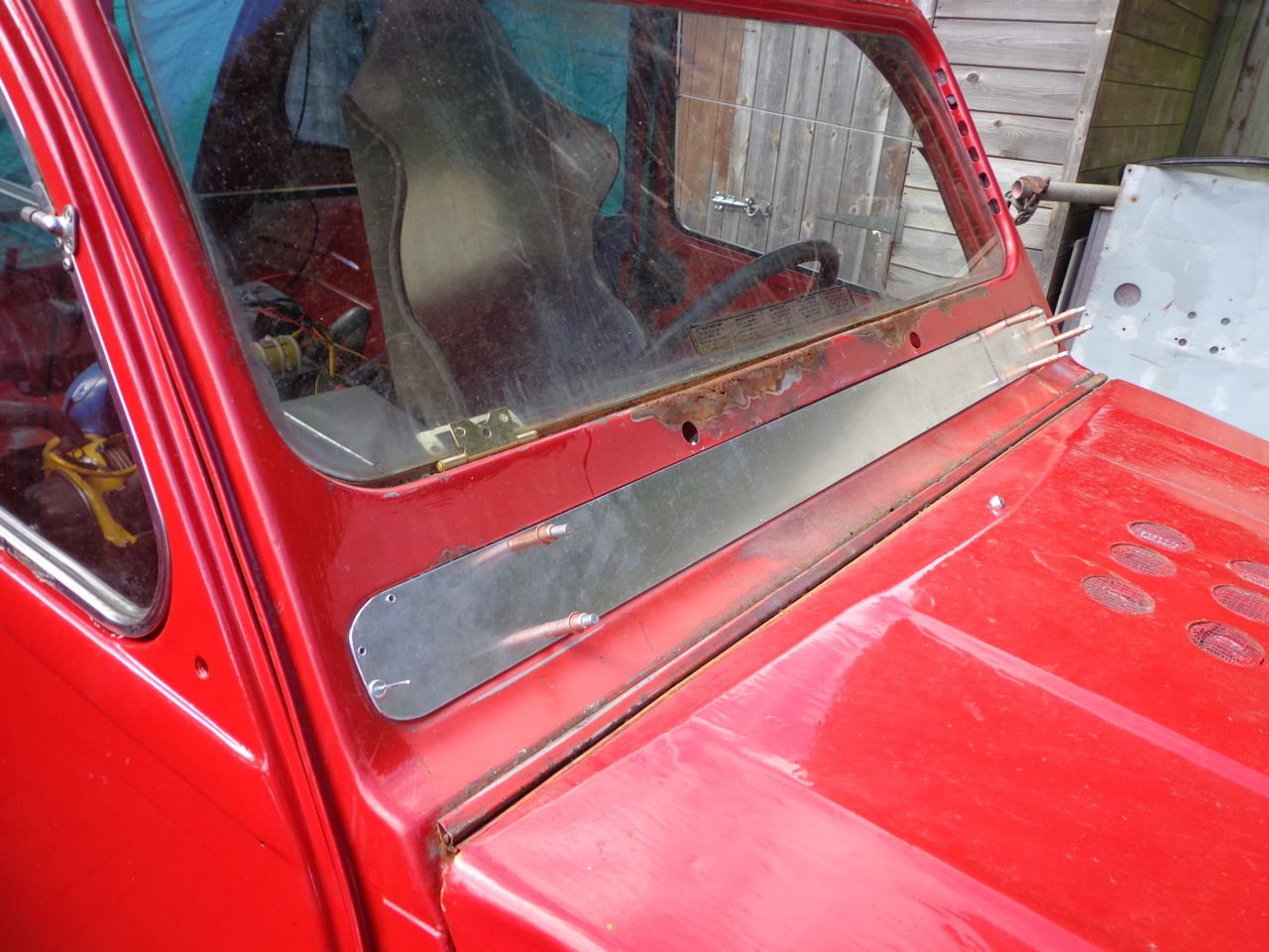

Grill fitted, found all the glass and most of the window parts now fitted, almost weather proof.
New battery and some "start you b*stard and it fired up.
With all the glass in.. gets very HOT just running the engine for 5 mins, so when on load will be like an oven...
Purchased a new Windscreen seal "OUCH" ....yet to be fitted

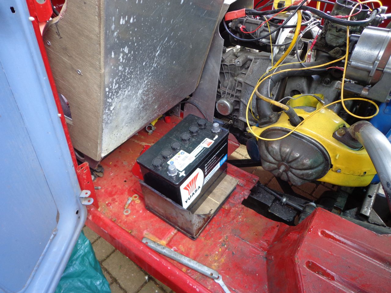

Battery Tray behind drivers seat.
Stain on the back of the seat, is from the previous battery left on Trickle charge!, it blew the top of the battery.

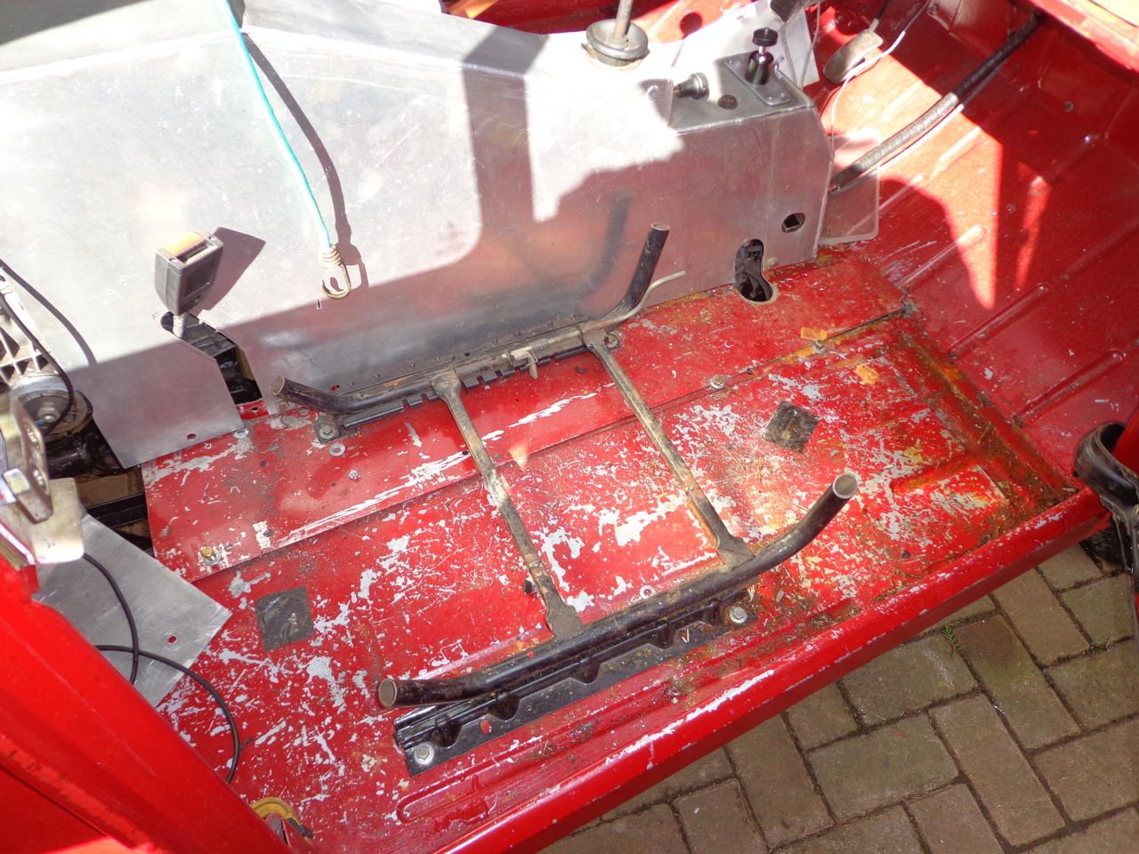

Cut down seat frame on passenger side.

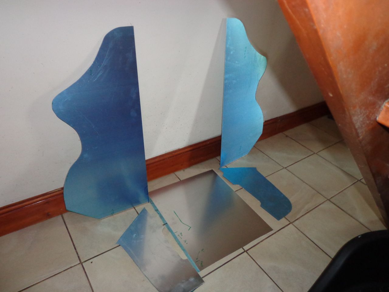

Alu Parts for passenger seats cut out from a pattern with a jig saw..
Need to be folded and then welded by a local tig welder

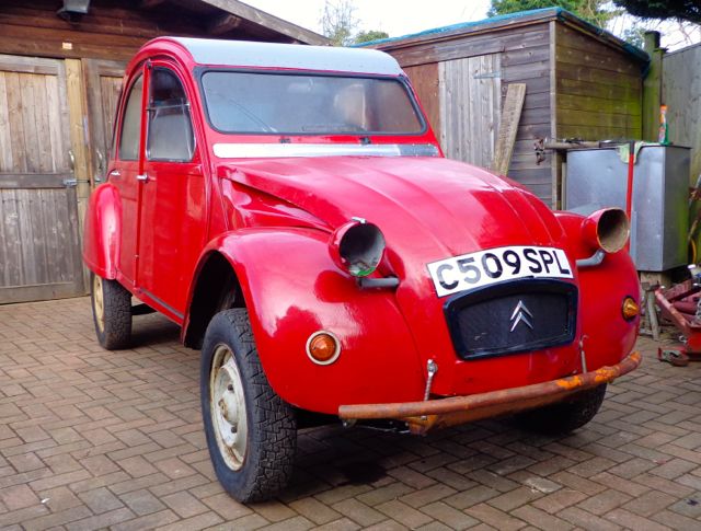

Ready for a test run....
