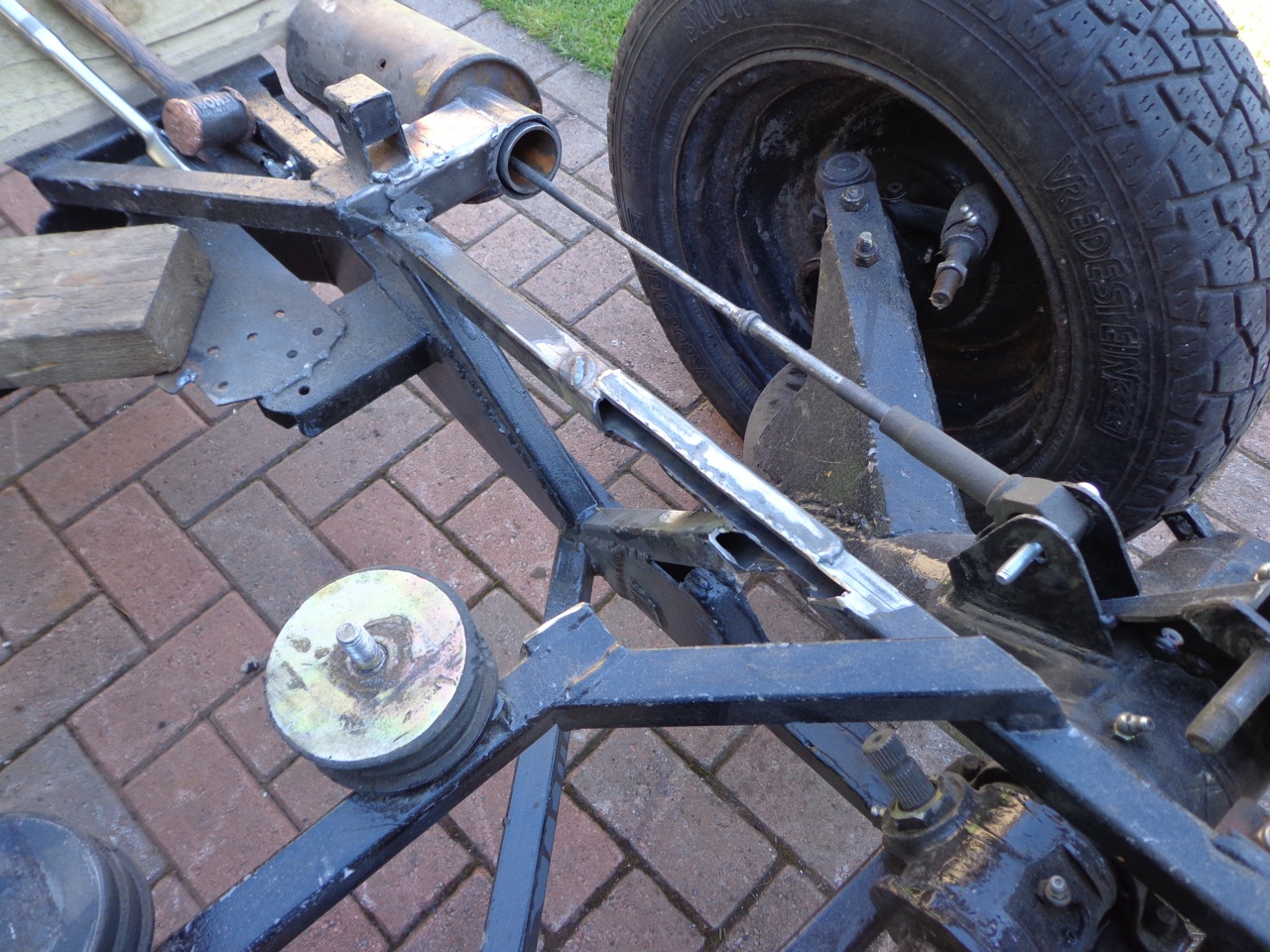

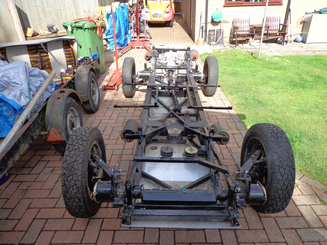

Some pics of front chassis and video
Have clearance for the tie rods etc, made larger mounts for spring cans also added a top rail to the chassis with triangulation.
On full droop steering just clears top of arms and the steering column, but this after numerous changes.

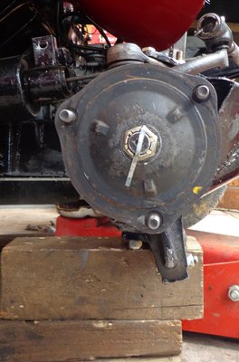

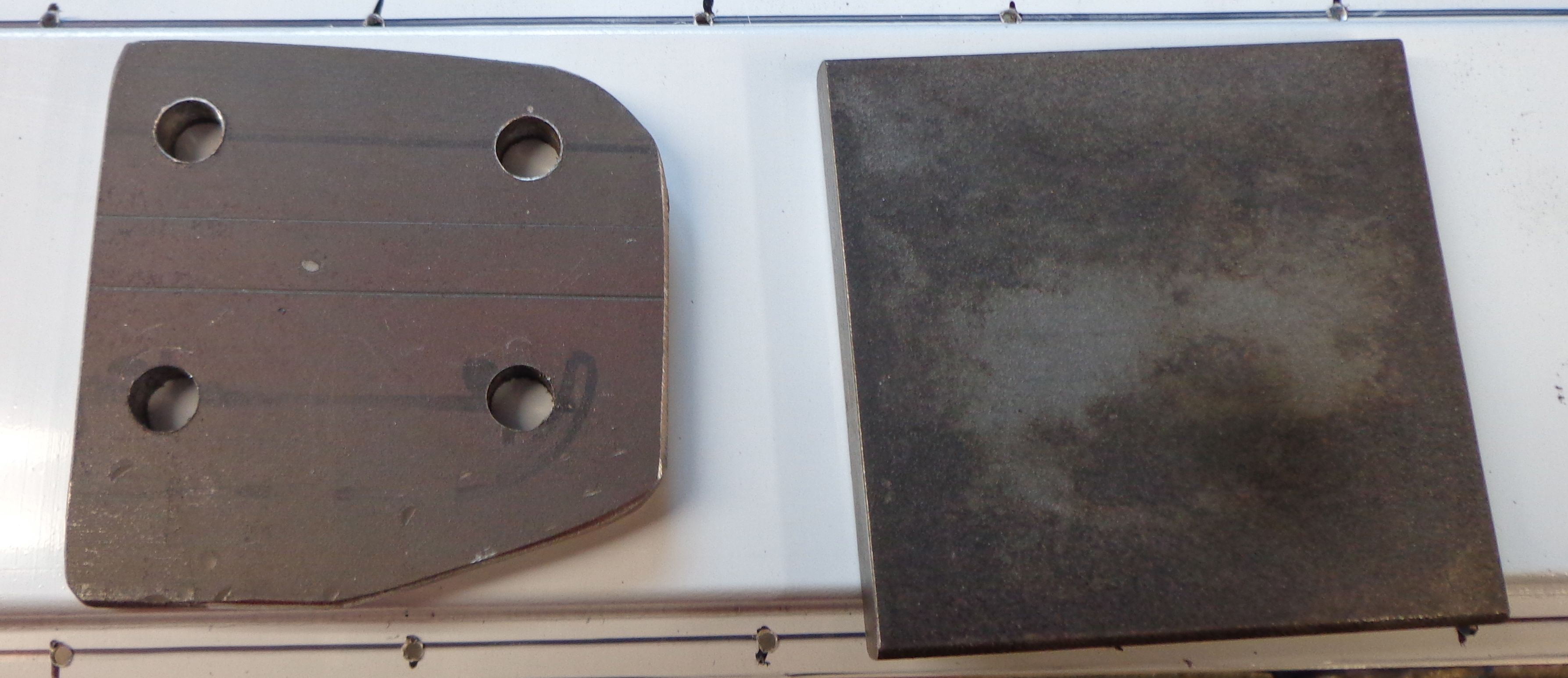

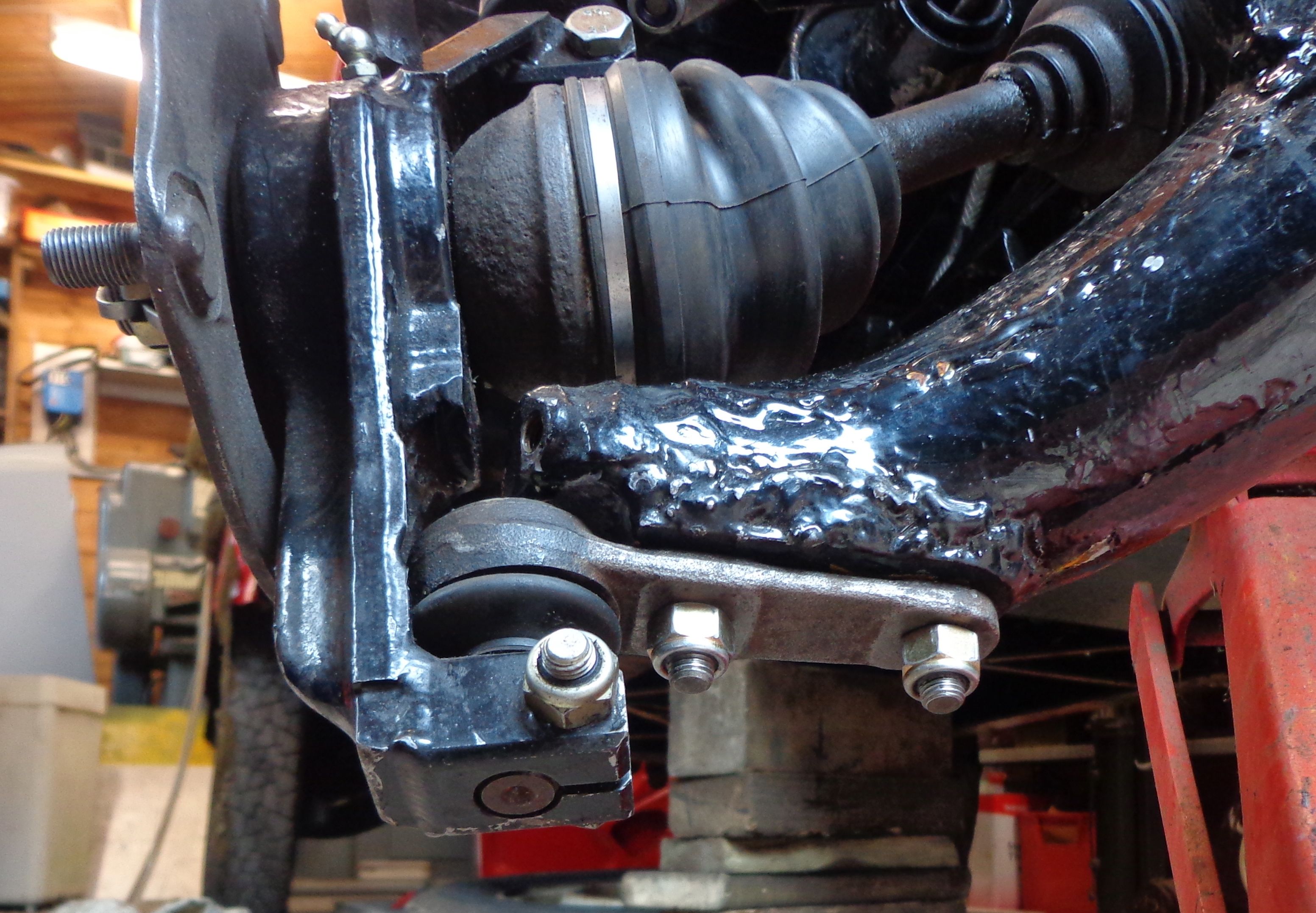

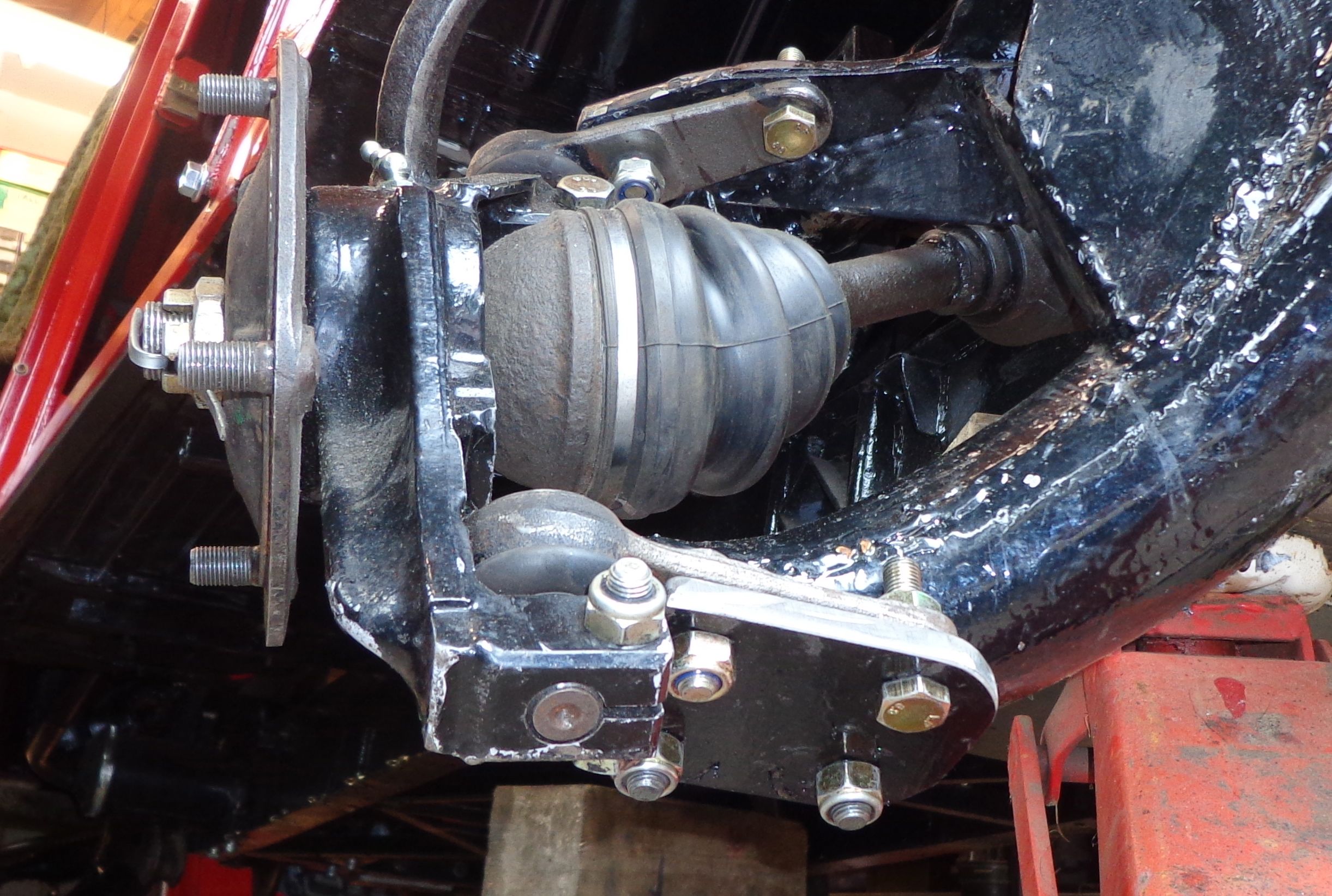

Castor Angle Solution?

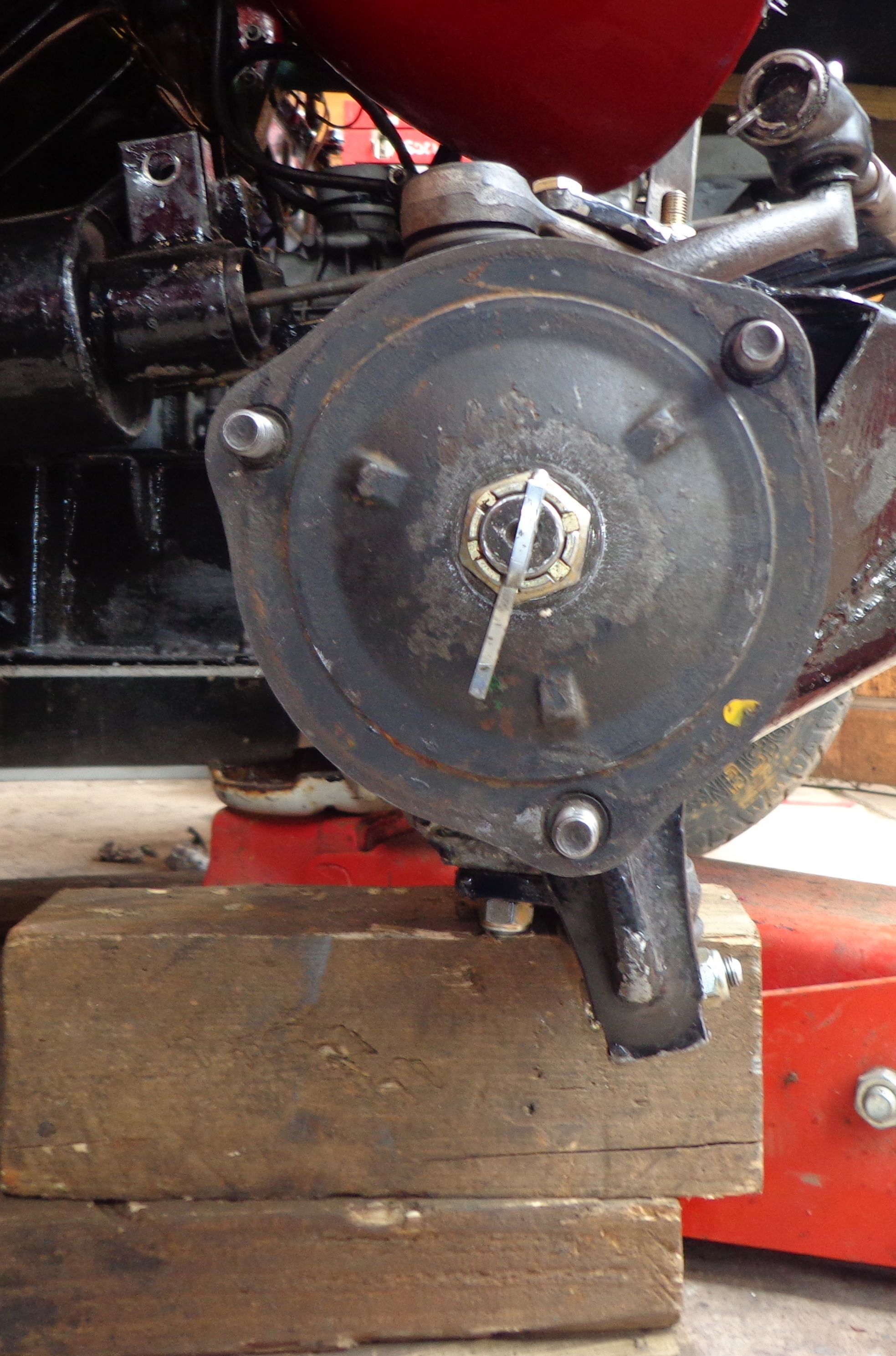

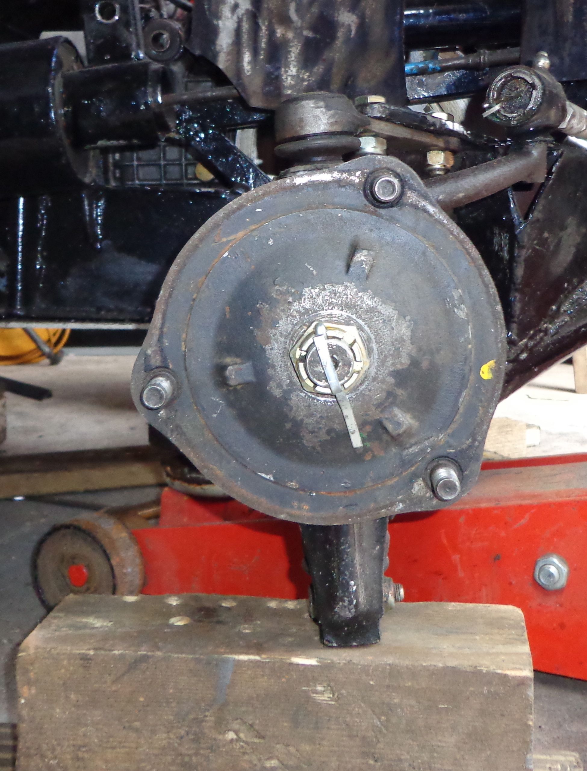

Have made a 10mm plate which moves the base of the hub forward.
Old
New
Old
New

Shouldn't your pic look like this / insted of this \ ??
Take a look at your standard 2cv and copy it....
and watch out when the springs compress your Castors changes is worse direction with your arms pointing to the back. Arms pointing to the front get stronger selfcentering when spring compresses. Your arms get worse selfcentering when springs compress......
I mean with springs compress that your ground clearence gets smaller.....
Hope you understand what I'm trying to say, (ps don;t know what I'm saying just a feeling)
please check for yourself so that you not got surprised when driving 60 on the road...
September 20th, 2013, 5:02 pm
Online
Posts: 2258
60? that will be "kph" then, if I have following wind :lol:
Trying to give it more castor, (than standard) at a normal ride height, just to avoid the situation you have described.
September 20th, 2013, 5:23 pm
Nice one - I think Geo has looked at your photo wrong- you are correct - 15 deg of castor and self centering - :) :) :)
