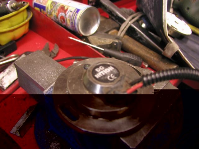

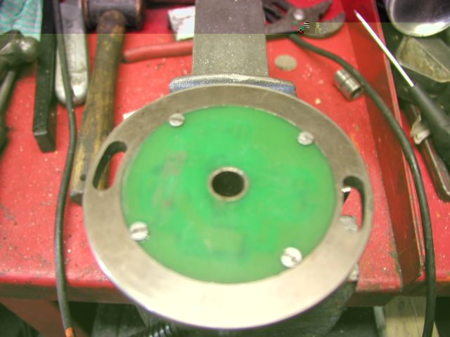

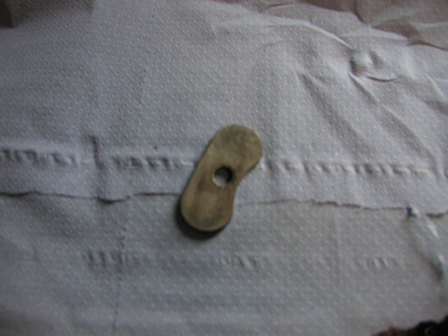

Ensure the seat where the 123 fits is clean.
Fit profiled washers in place of the square ones to seal the adjustment slots.
Use sealant round the cablejoint .

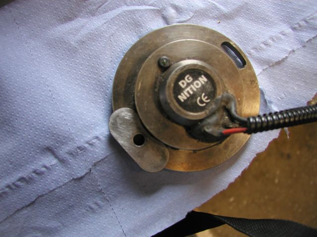

After adjusting/testing ignition seal round unit.
This set up has survived numerous immersions.
Note A DGNition has no holes in the PCB so is slightly better re waterproofing

I see that the electronic ignition in your pics is not the 123 ignition that I have. Do the same principles apply to my 123 ignition, especially behind (on the PCB)?
Steve
April 24th, 2009, 7:19 pm
Posts: 2257
Post Re: 2WD Budget Off Road 2CV? is it possible?
Same applies to the 123, but be more careful about ensuring a perfect seal as, if you look at the back of your 123 the PCB has many small holes in which allow moisture into the electronics if it get through the sealant.
I have a 123 which got soaked and failed, 123 will repair for €50

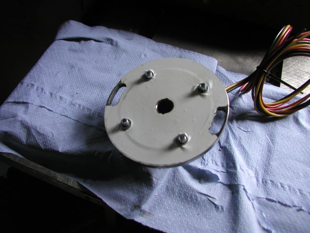

Back of my 123, different bolts with large washers and sticky-back plastic "Fablon" from yesteryear. But haven't tried it!
