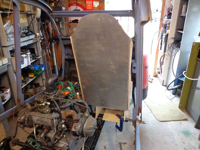

Going to be warm and cosy.

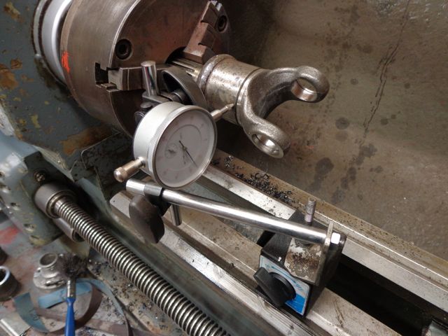

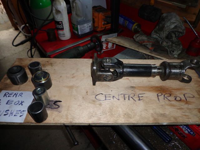

Lathe now going. :D

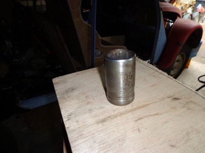

Machined up centre-prop and did some revised rear gear-box bushes and the first of 4 drive shaft extensions
Drive Shaft extension
Checking prop shaft run-out.

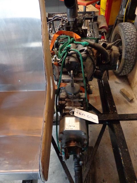

Last few days.

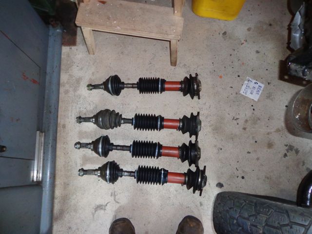

Drive shafts + extensions.

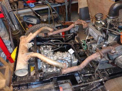

Exhaust with some standard bits - re-arranged.

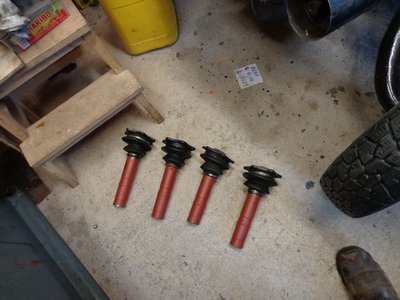

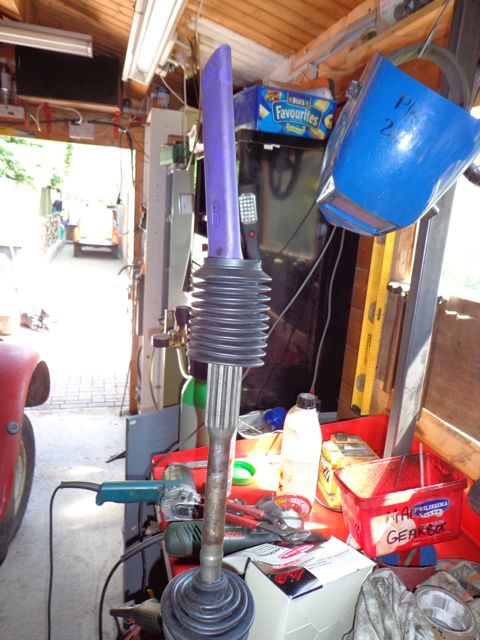

Drive Shafts finished.

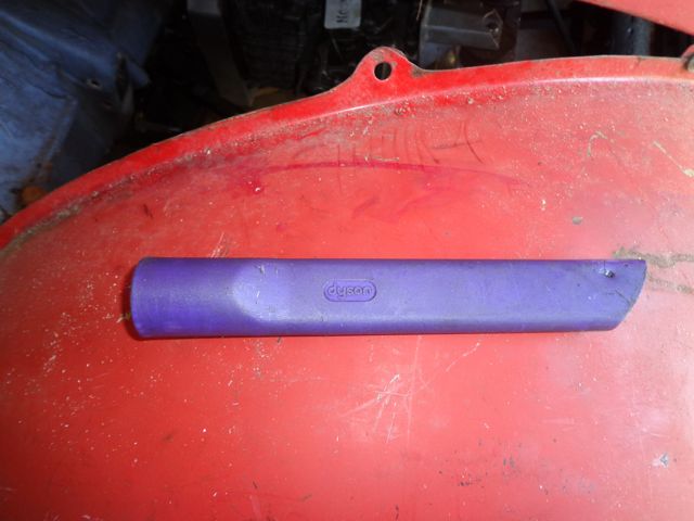

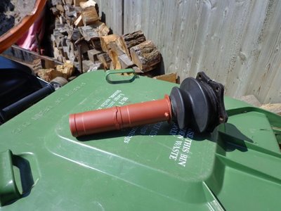

Tool for fitting Gaiters, from vacuum cleaner, works with Middle, Inner and Outer.
(seen on another forum)
May 23rd, 2012, 2:42 pm
How do you explain all the grease on the tool to the misses? :lol:
May 24th, 2012, 7:33 am
Good old' dyson
May 24th, 2012, 7:35 am
Online
Posts: 2258
@How do you explain all the grease on the tool to the misses?
Do the vacuuming :o or Spare from ebay
@Good old' dyson
Admired the Guy anyway, now more so ;)
