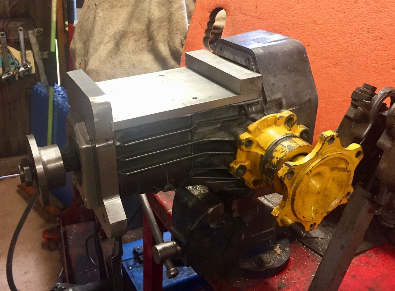

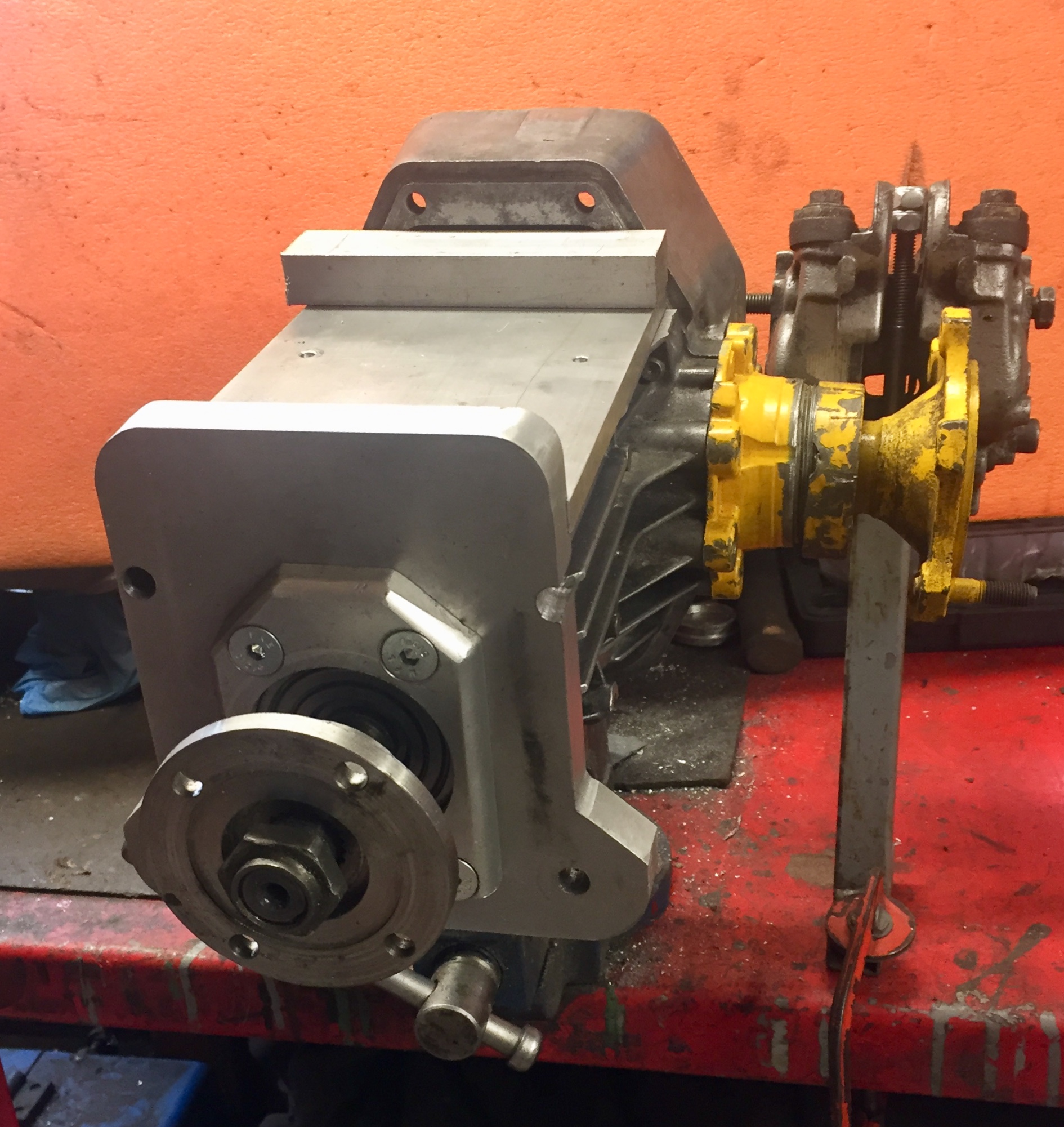

Lockdown... So have been working on a stand alone differential, callipers positioned, as when on top they fill with crud and brake pads wear out very quickly.
Will need to get it Tig welded some time in the future?

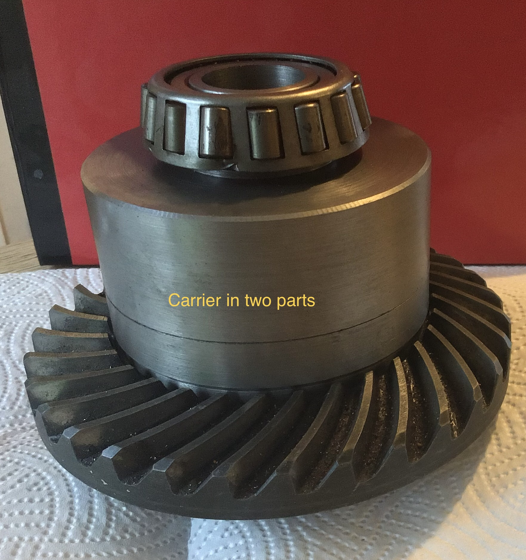

Part 1 Diff Carrier.
Part 2...... pins for Satellite gears 2 maybe 4!

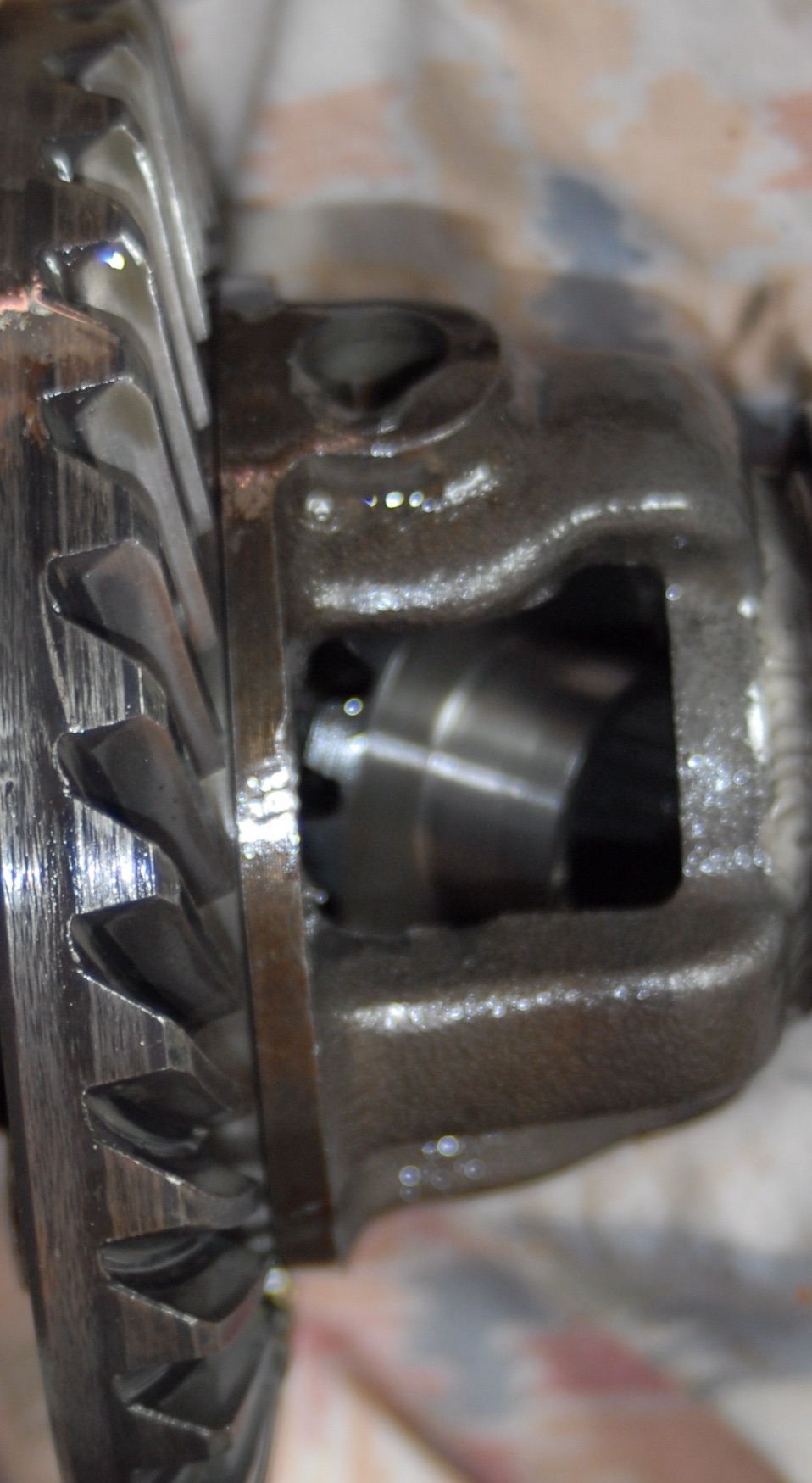

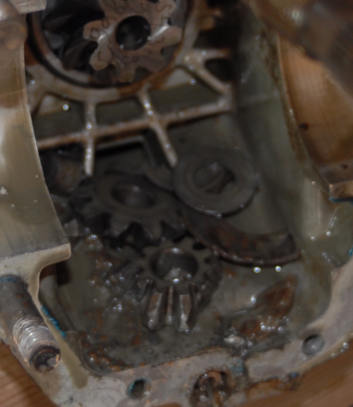

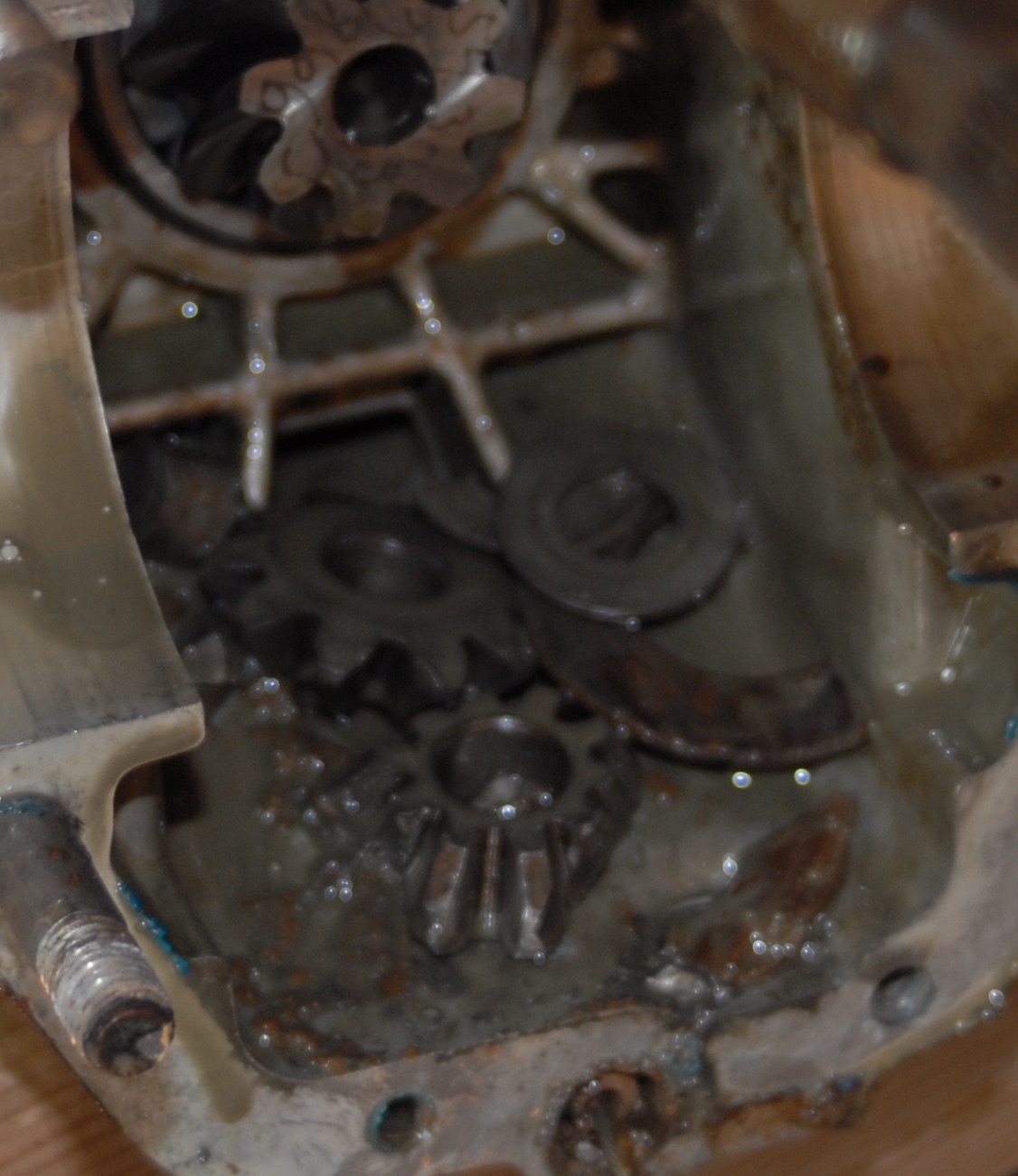

Here’s a diff I damaged earlier...
