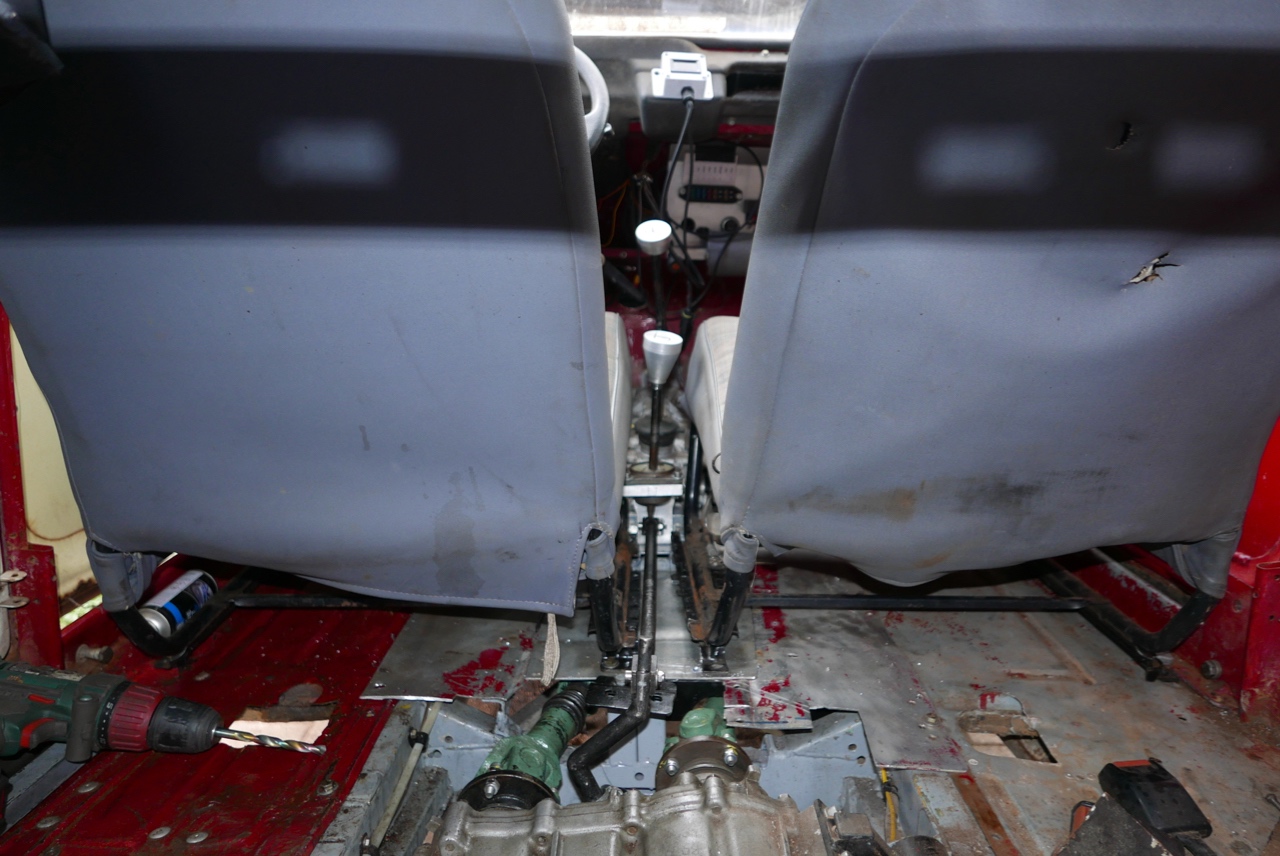

Could not get this transfer box selection lever to work properly.

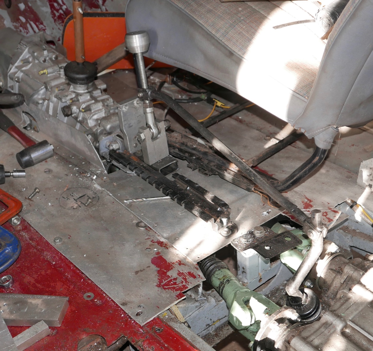

So Google is your friend, found a few pics and came up with a tidier? solution.

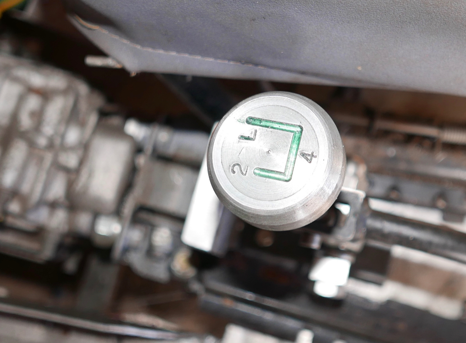

Knob yet to be polished.

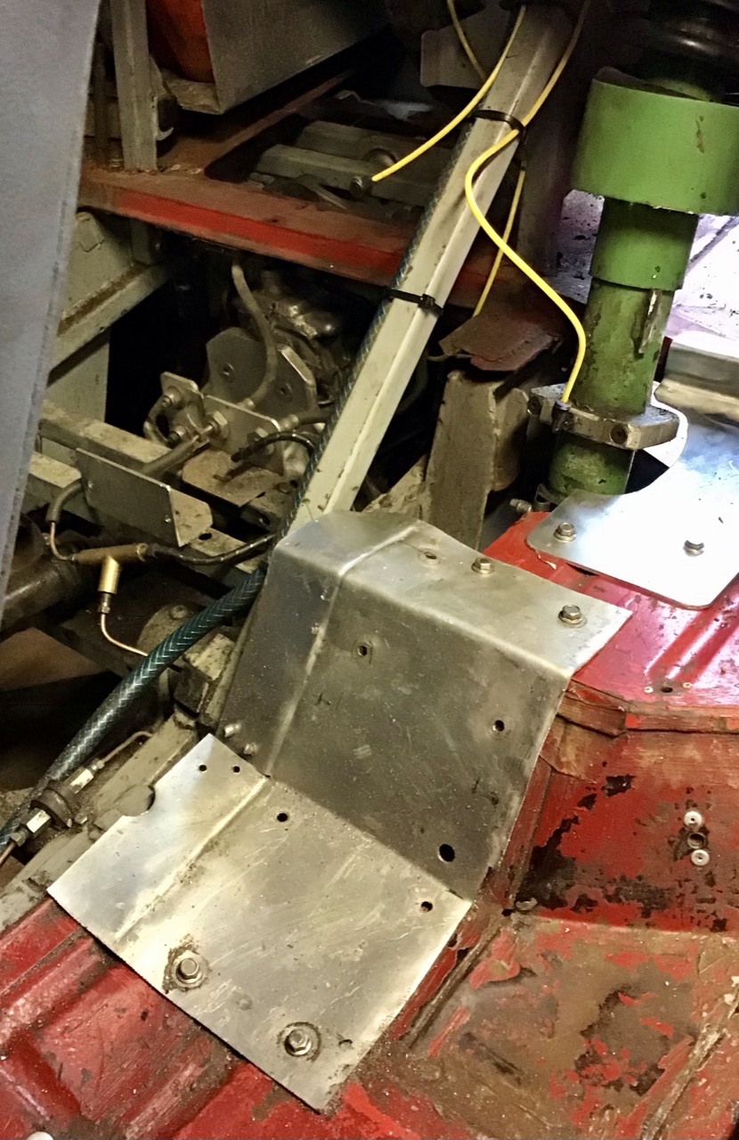

Gave up on welding thin steel :|.
Re-used some alu plate, not pretty but does the job.
