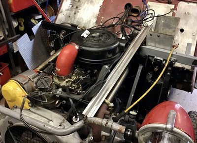

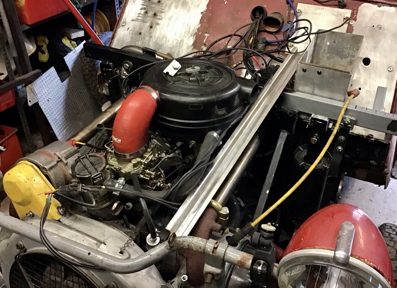

Wires and exhaust don’t mix, will use an Ally channel to keep it tidy.
May wrap the exhaust when,,,, if it works all ok.

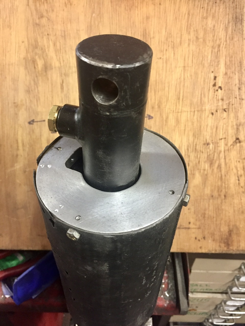

When the suspension drops, the springs wanted to come out of the spring tube, so they need a plate to keep them in situ.

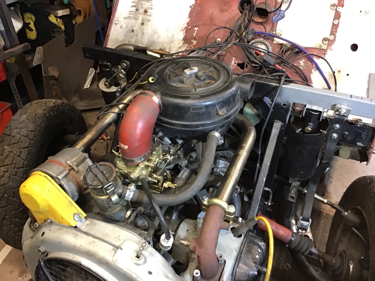

Shiny new carb, from EBay was remmended and 1/2 price, time will tell.

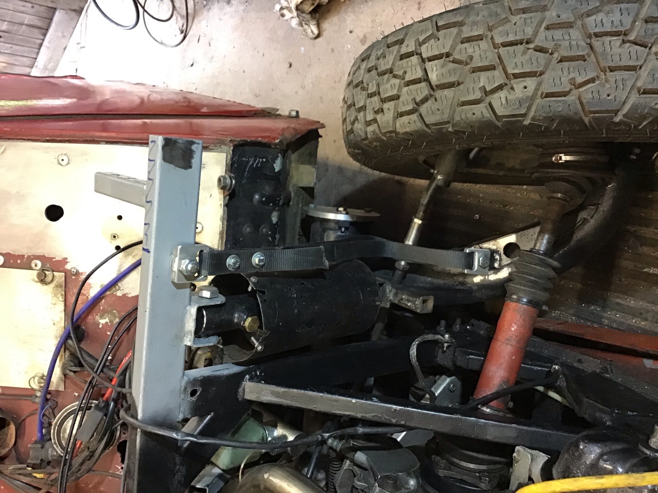

Suspension at full droop.

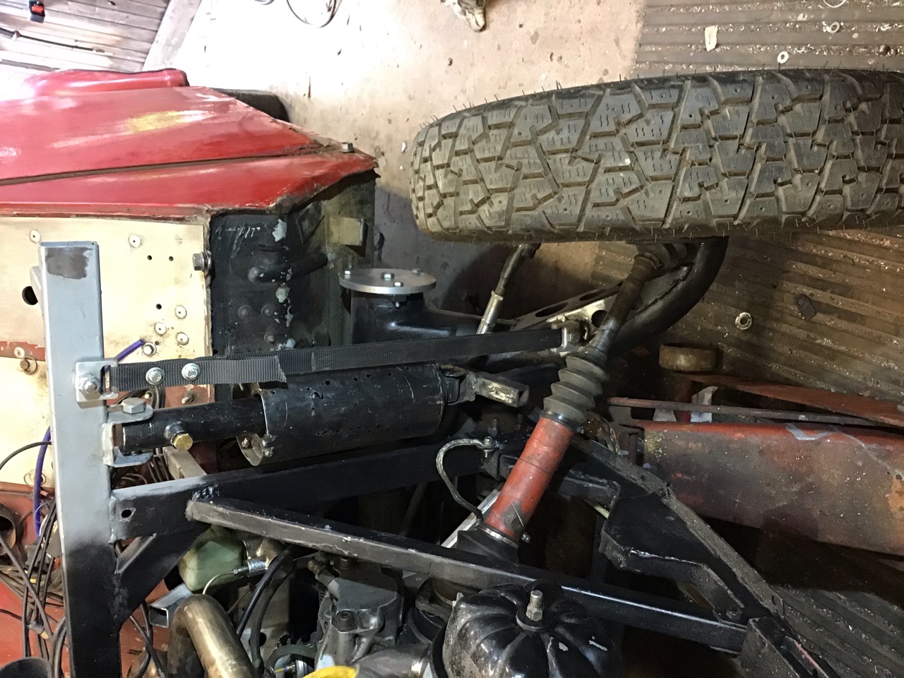

Suspension static load, abandoned the top plate in the spring can as it collides with the ram oil feed.

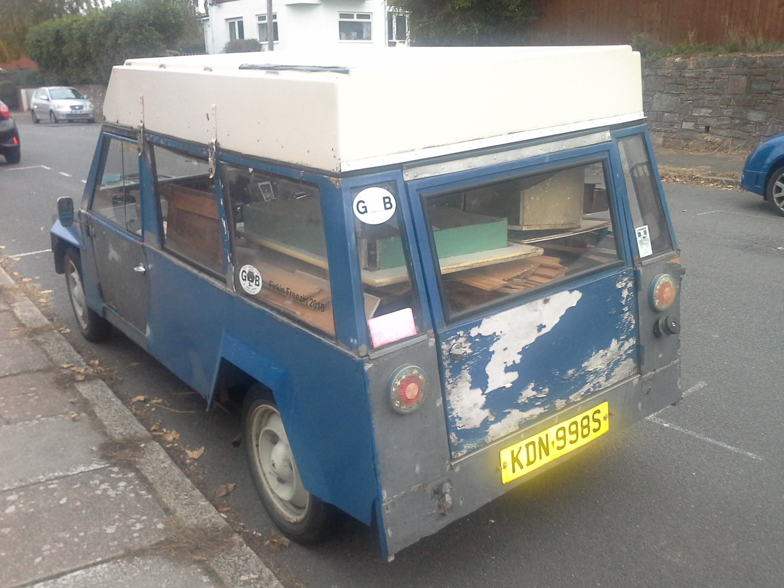

Actually, this just me over loading the shed to take stuff to recycling. :)
I got some funny looks from motorway police patrols. :D
And a wave from a blood bike ...
