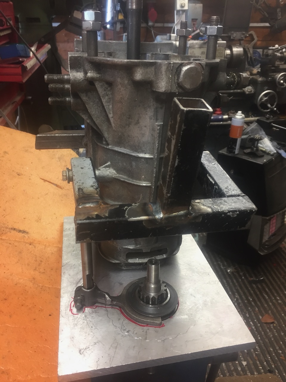

Try out for the additional shaft, with dog selector.
Re-using a top shaft and the third gear dog selector parts.
Ignore the large hole in the casing, this was an attempt to use gears like a Mehari 4x4.

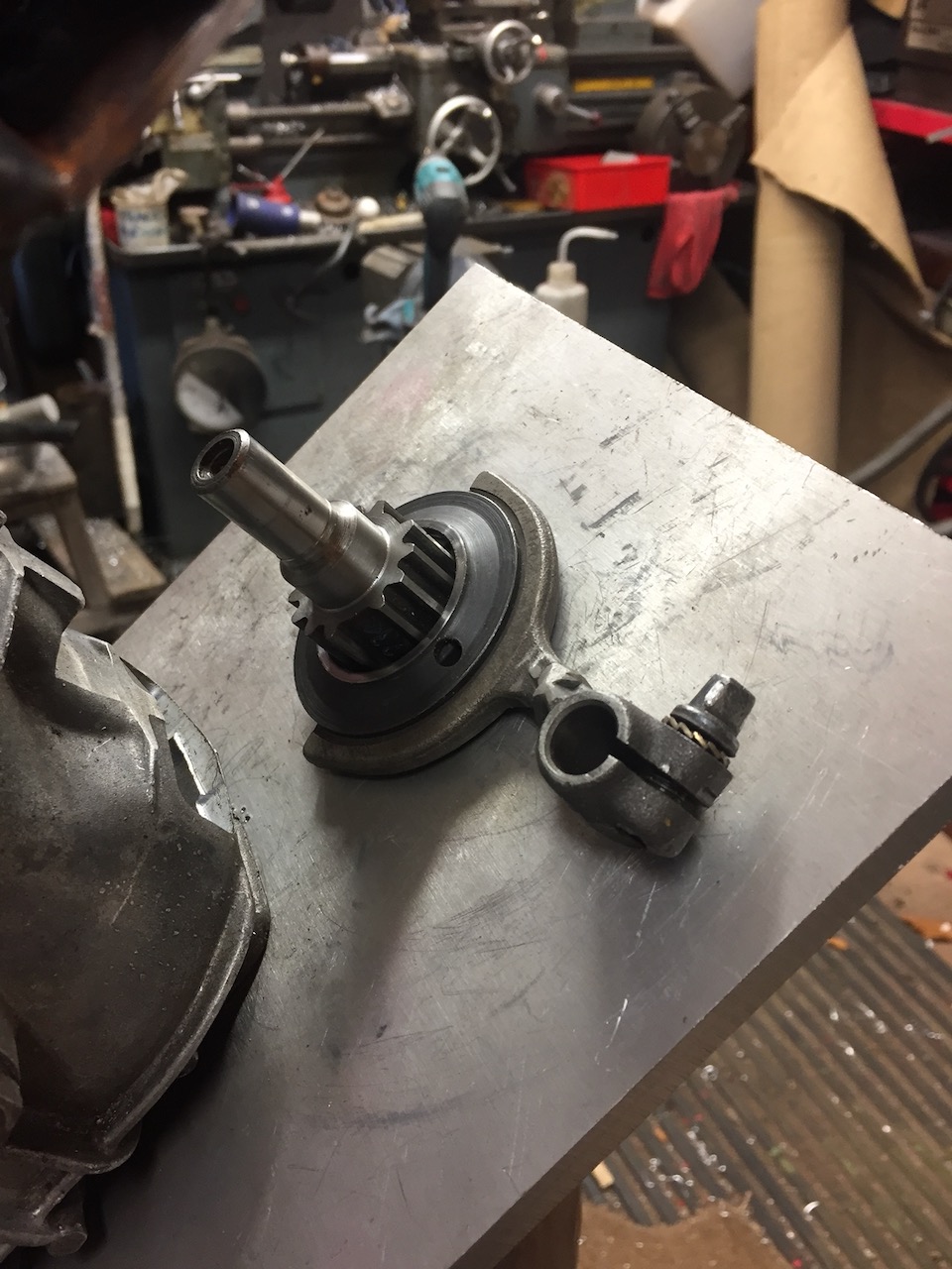

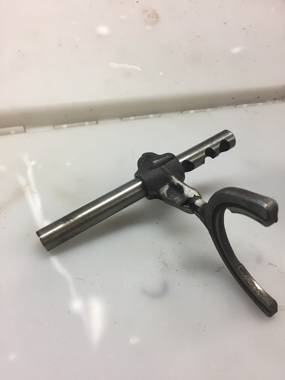

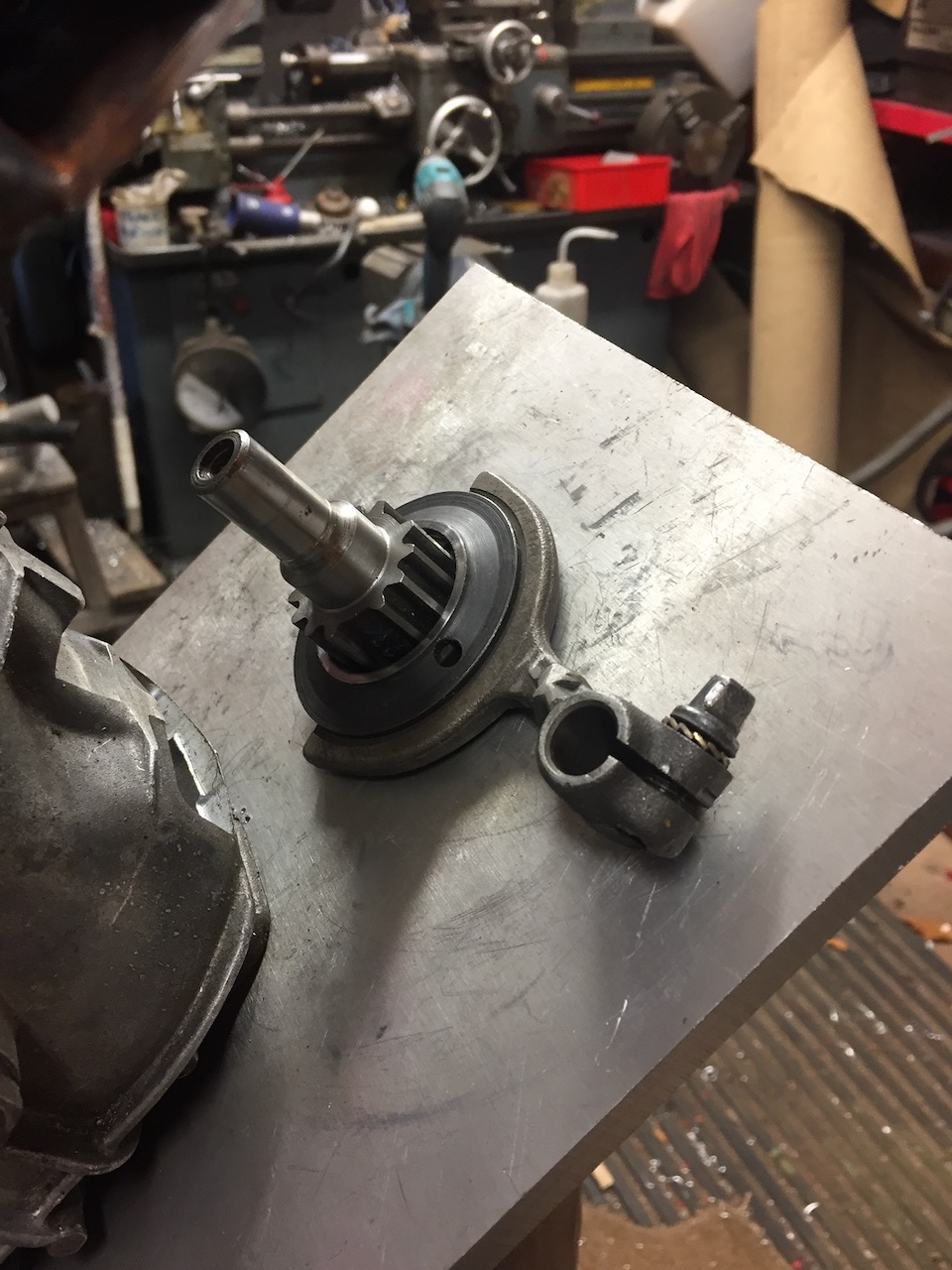

Fabricated selector fork from 3rd gear items.

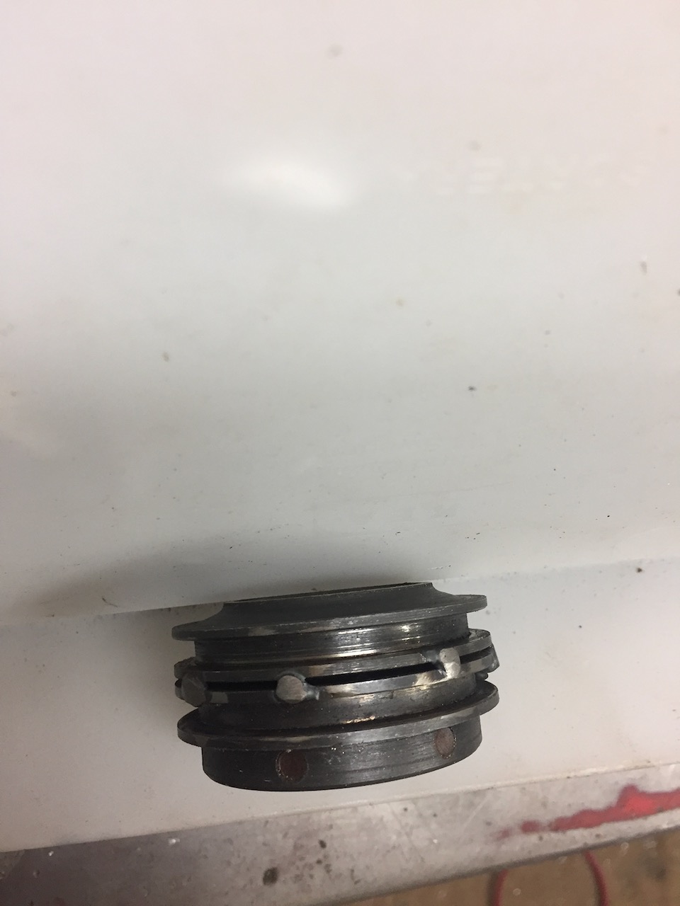

Extended synchronizer ring.

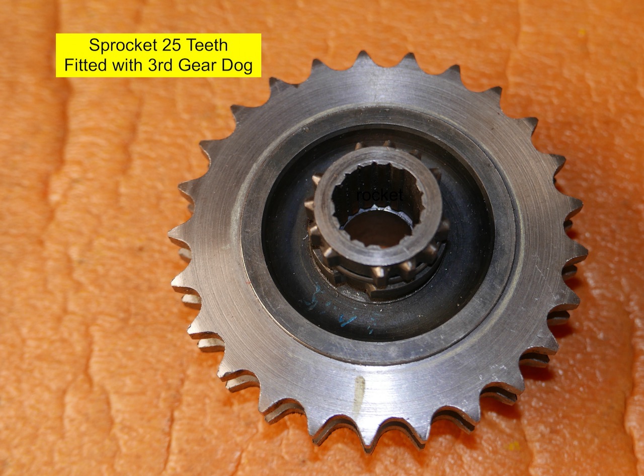

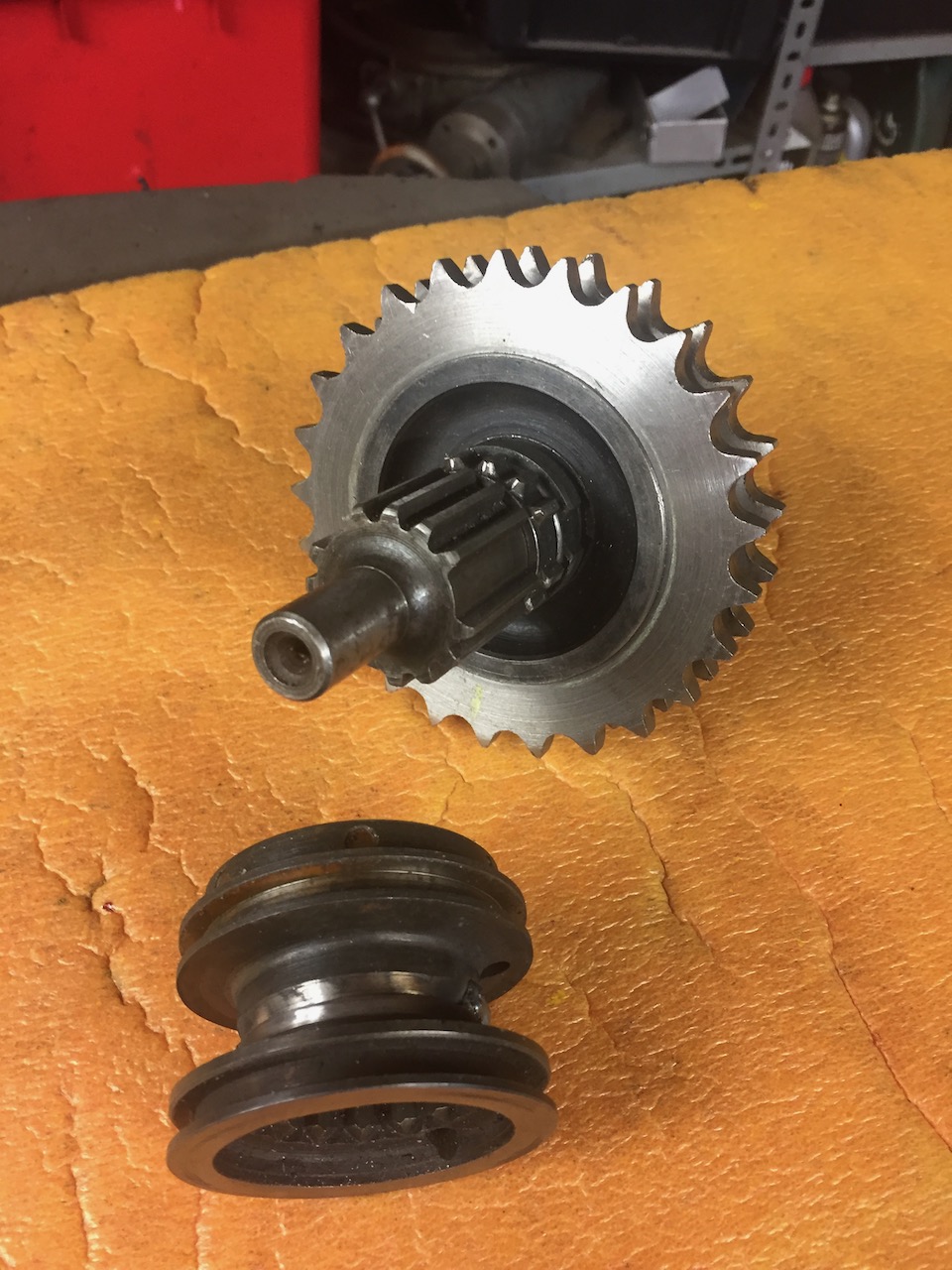

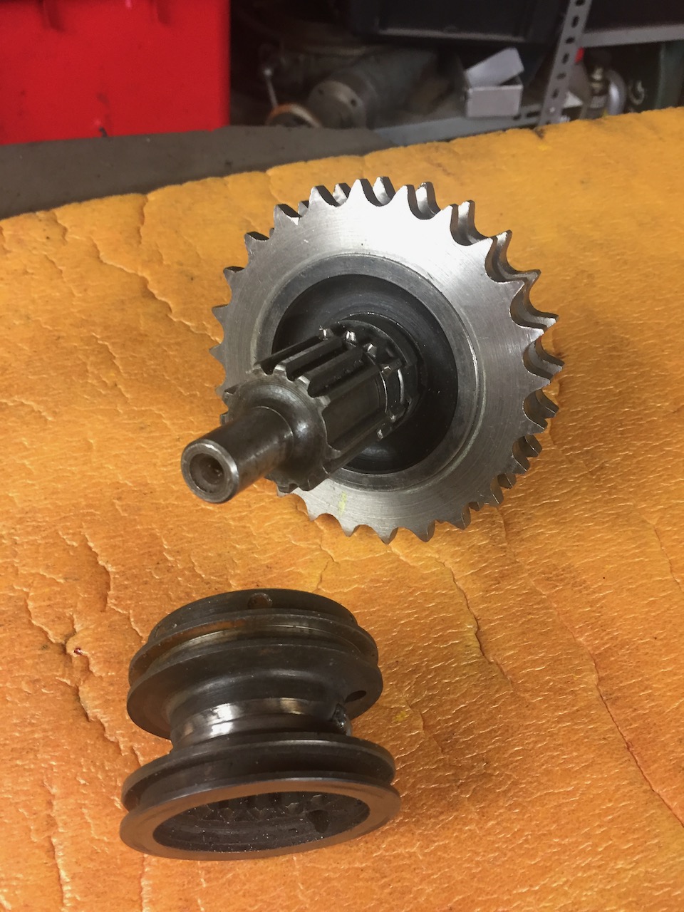

Sprocket.

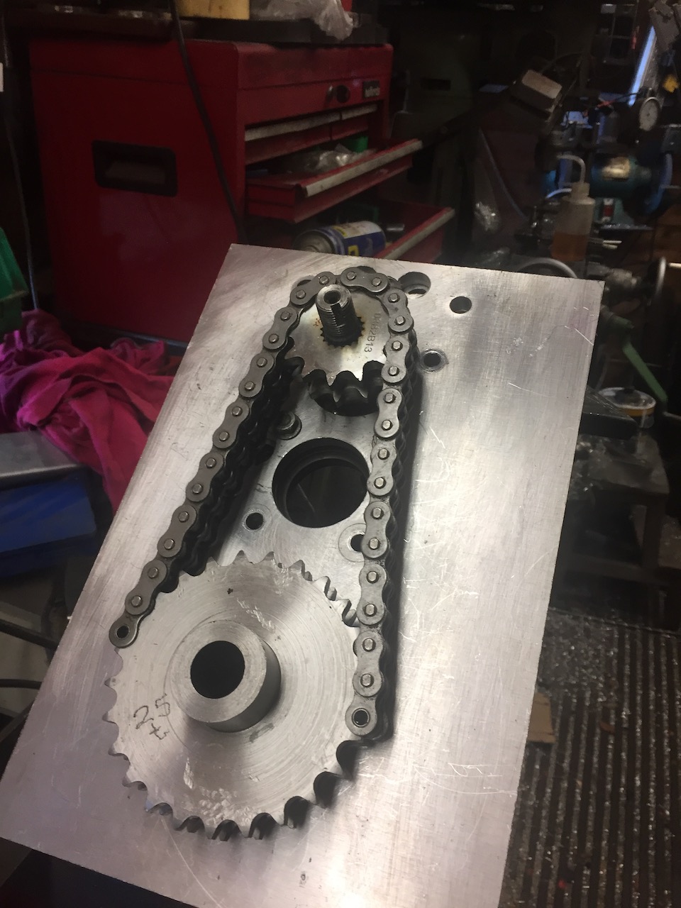

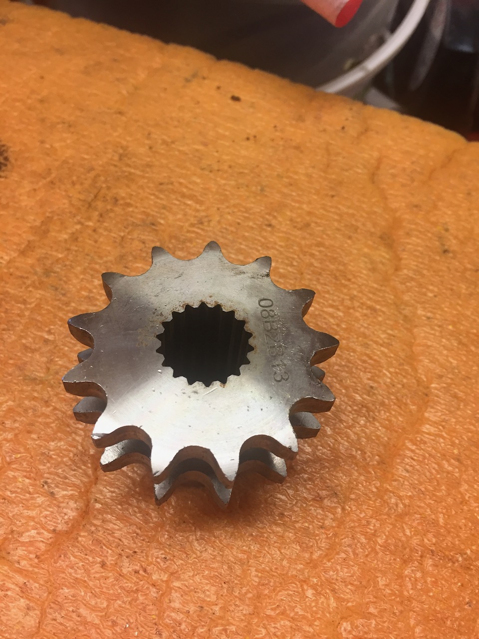

Got the 13 tooth sprocket, splined done with EDM (wire cut).

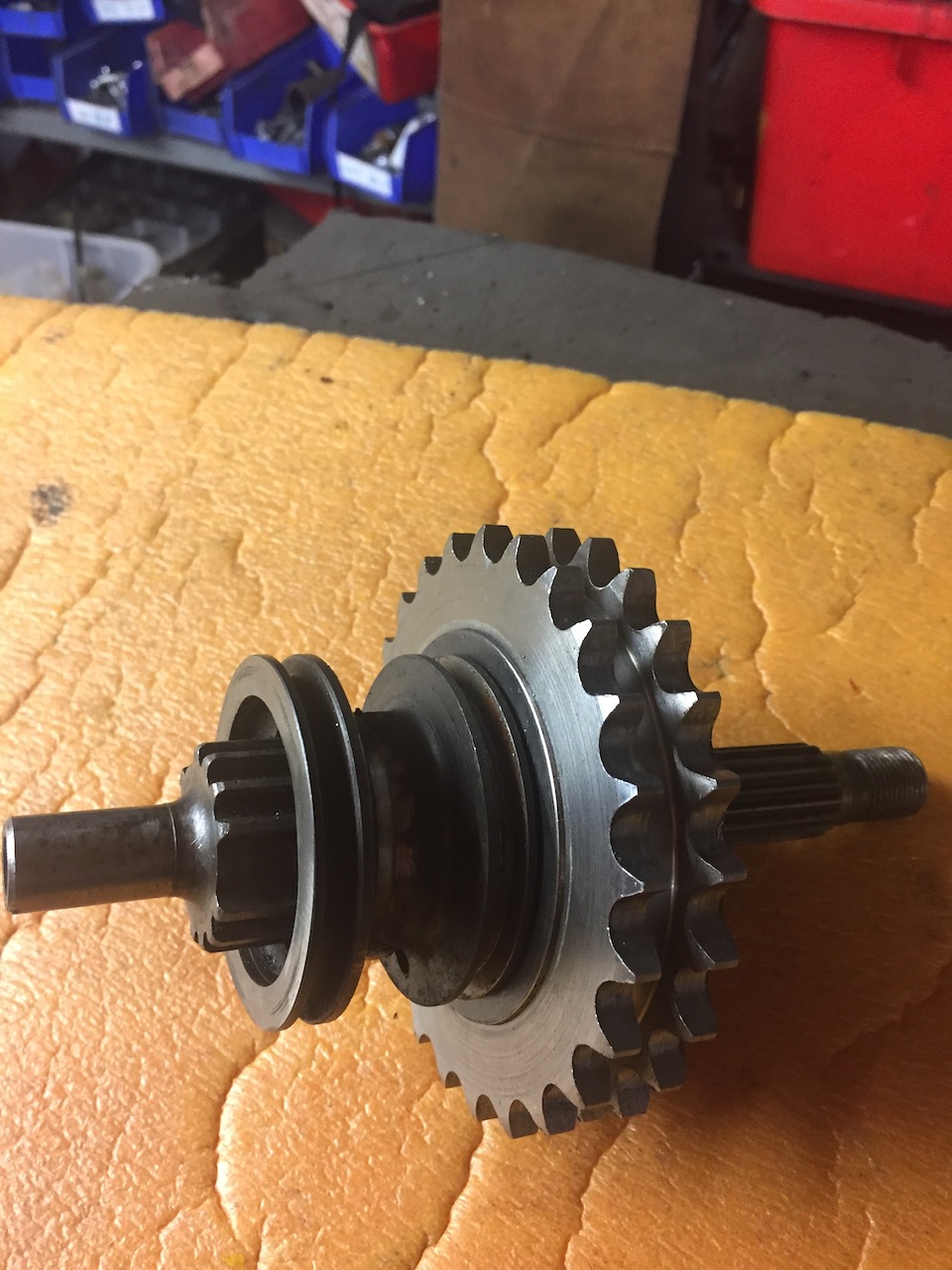

In situ on the top shaft.

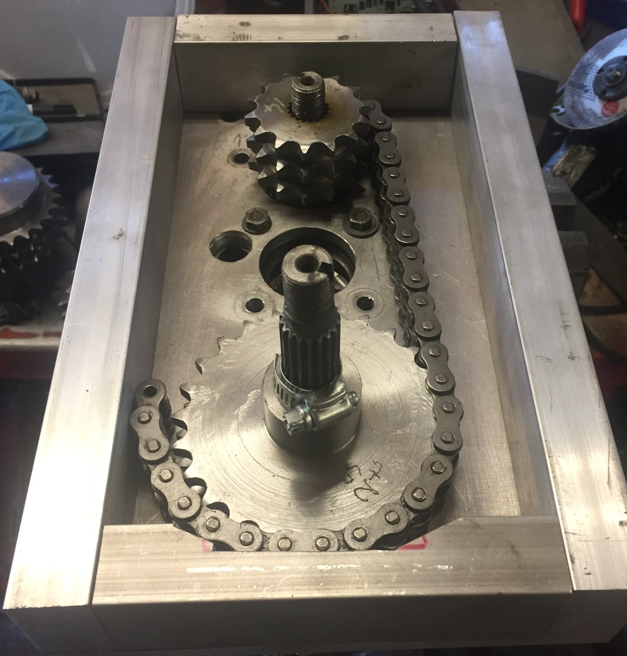

Chain and sprockets in alignment, need to fabricate a a longer syncro/dog selector.

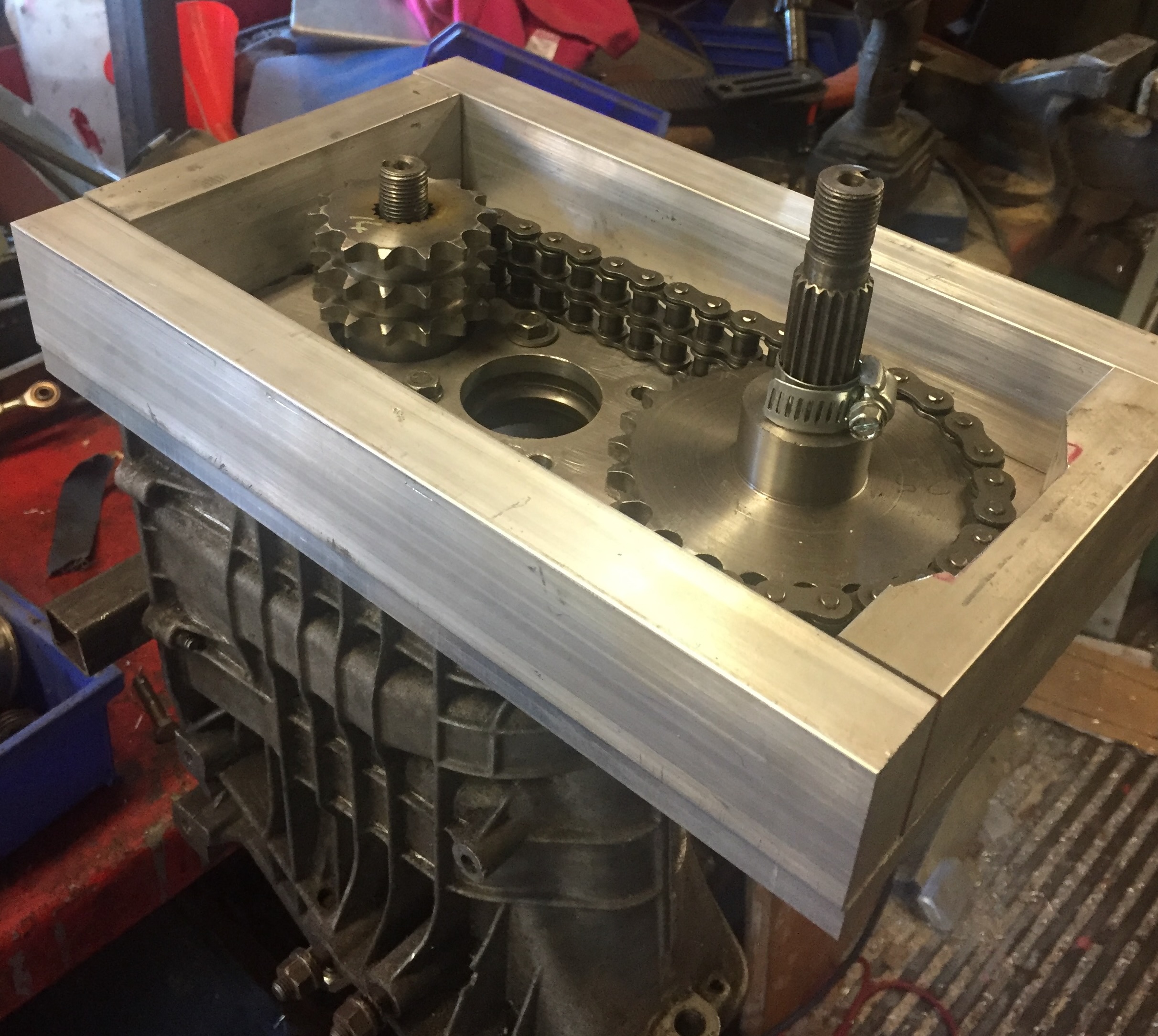

Started to fabricate the rear cover, seems there is room for a trilpex chain:)?
