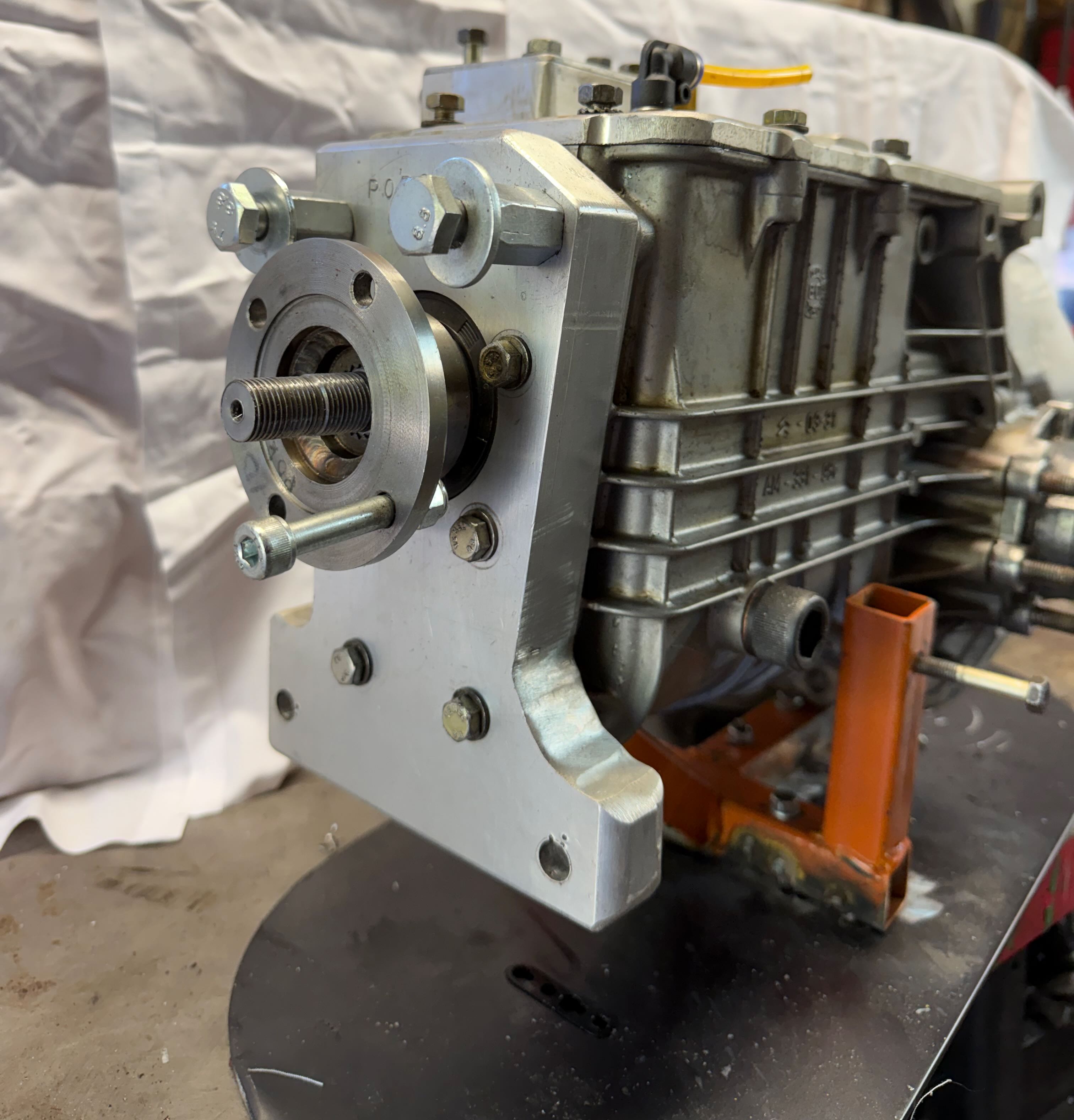

I have had a new longer top shaft machined joined to the bearing part of the input shaft.
The small gear slides to engage. the whole box is used the other way around
