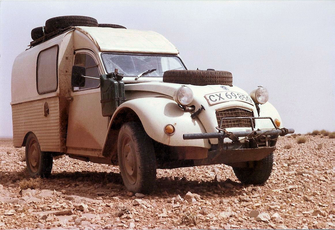

I used to drive with one my self but it is heavy and if you are raiding with other people it is easier to be pushed by helpers or pull with other cars. But I have been quite happy for it a couple of times especially when driving all alone in mud.
When using a winch in sand you have to dig for eksample a sparewheel down in the sand or have a set of anchors and all this takes time to set up.
We will mostly be going into the sand for playing with our cars and a part of the fun is to get the car rolling after getting stucked.
So shortly you wont need it and most of the time it will be ekstra weigt - one the other hand if you wnt to play with that kind of tool - then I shall be the last to shake my head...

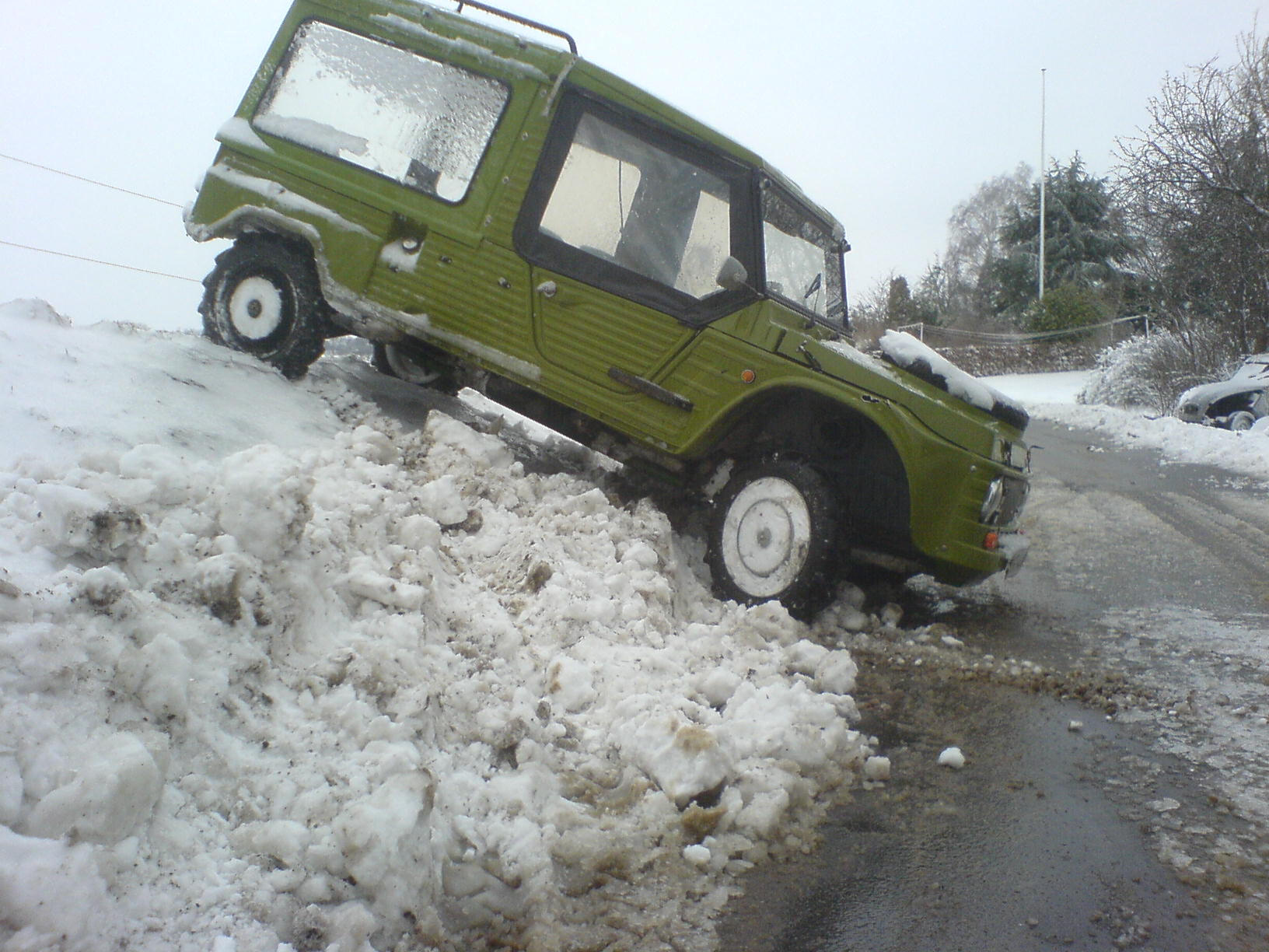

One tool that I have been using with a lot off succes is a dynamic rope 15 to 20 m long.
With this rope you just park as close as possible to the stucked vehicle attach the two with the dynamic rope and get your 2CV running as fast as possible (10 to 15 km/h).when the rope gets tight you can eventually press down the clutch to awoid getting stucked yourself - this tecnique allows you to pull a lot more than one thousand kg (over a short distance) witch is mutch more than for example a big 4x4 can do by using its traction on sand snow or mud.
I have helped many much heavier cars stucked typpicall in the snow, but also for example a VW transporter in sand, by using this metod.
Usually I dont tell people how it worked just leaves them astonished over the 2CV´s performing - wicth actually had nothing to do with it.
This dynamic rope overules a Mèhari 4x4 equipped with agricultural tyres when it comes to pulling force - but they can certanly be effective together.

Do we get snow in Africa...!!! Image
At winther time in the Atlas, yes- but im not sure about july - maybe we should considder adding snowchains to the must bring list...

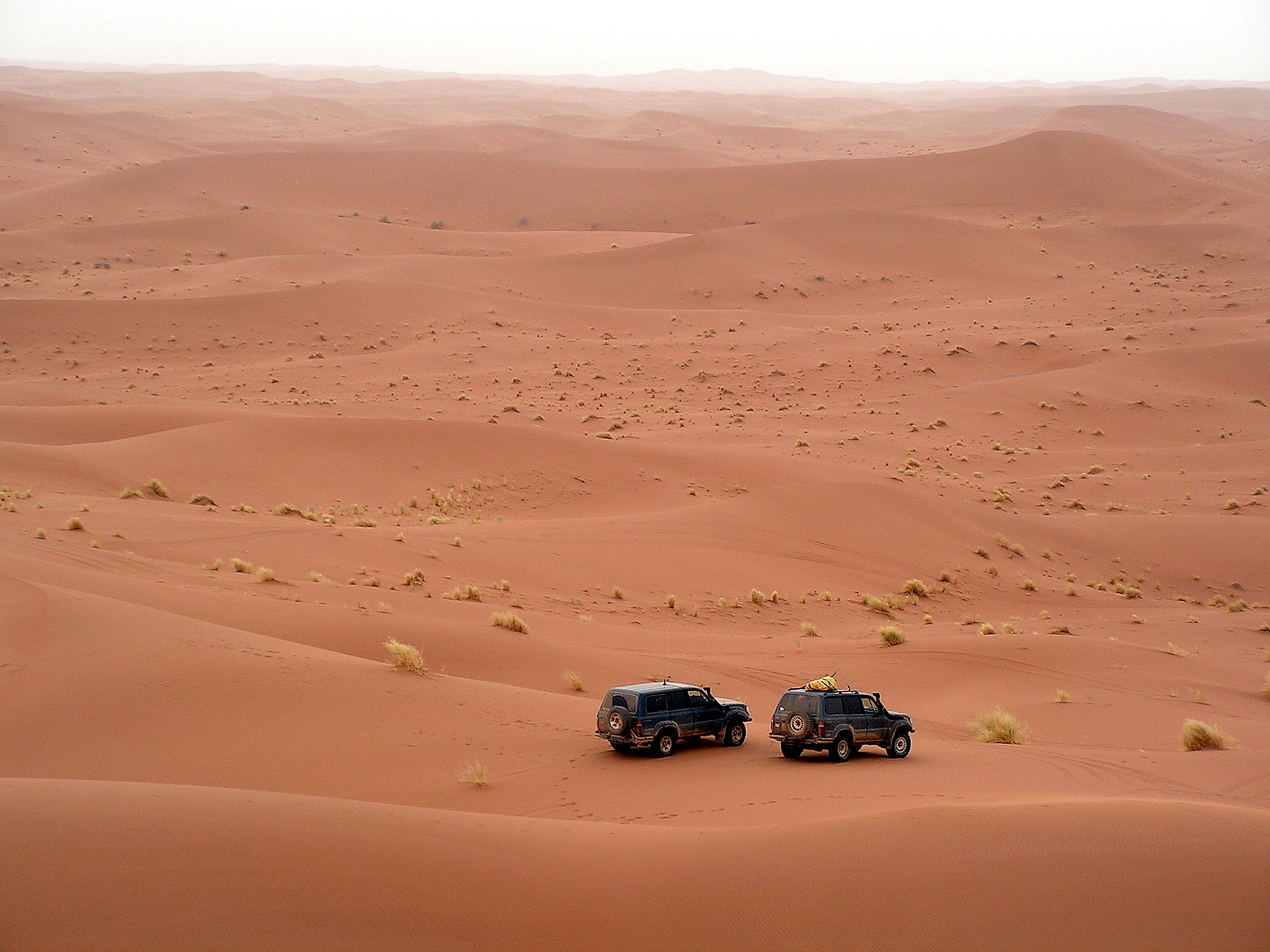

Une aperitif - this is where we should be next year on the 12th of July (happens to be on my 50 years birthday)

Lovely, looking so much forward to this. Don't forget to bring or make a birthday cake. I think it will be a sand-cake :lol:

dunes lke that are restricted to a small corner of Morrocco
