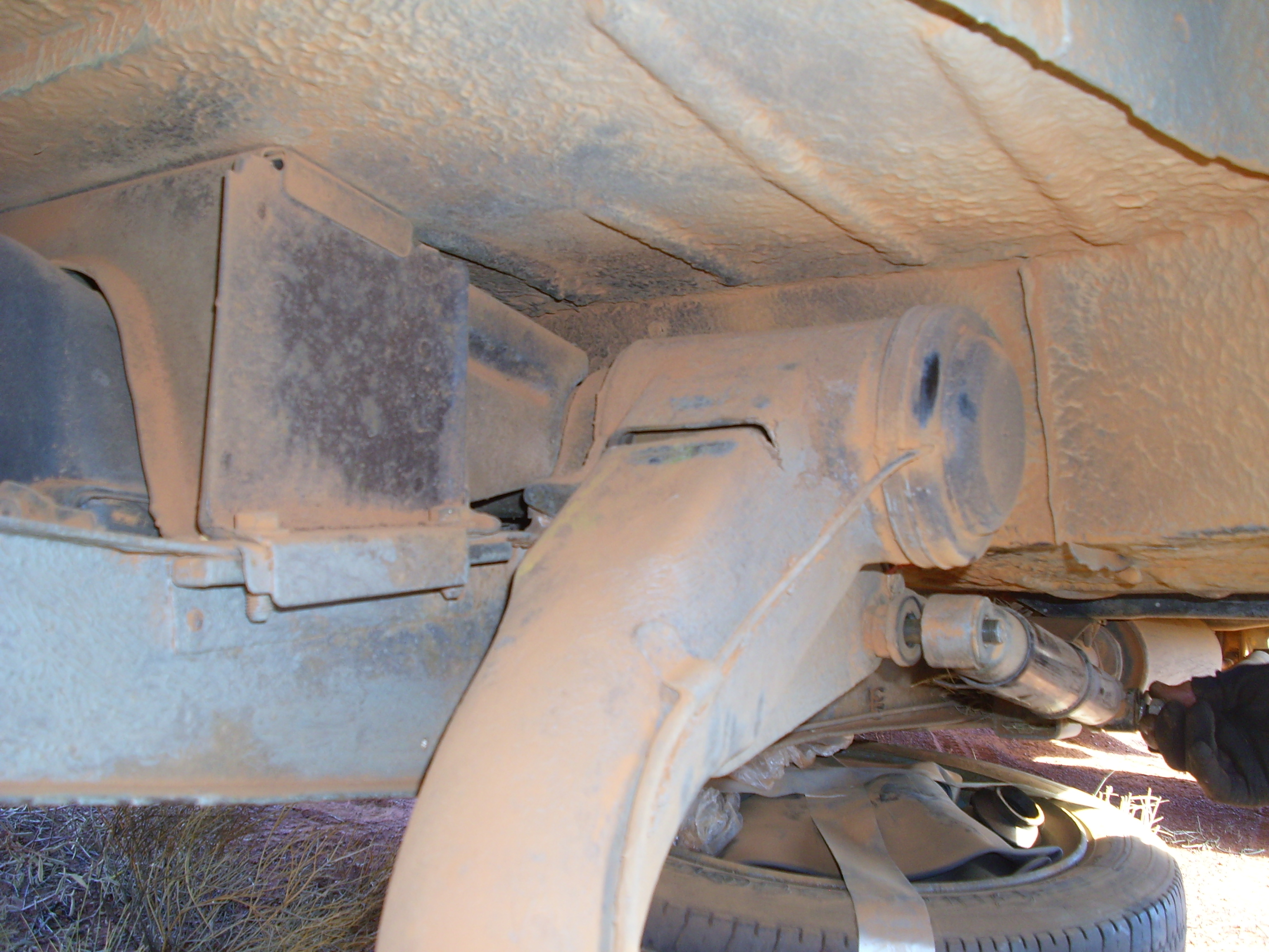

Post Re: Travel light
Viking,
years ago, I'd heard reports of 'mysterious' breakages of rear arms during Raid Australia.
Seeing this picture, it's hardly a mystery.
Looks as though they'd even being using the rear bumper to grade the track... :lol:

ken wrote:
Viking,
Should have left that job to one of these
< http://www.brookshire.com.au/wp-content ... r-140h.jpg >
2CViking wrote:
In contrast some Aussie raiders had the benefit of being ''home'' and you should see the amoumnt stuff they put in their cars. Completely unnecessary, some of the 2cv's doíng raids were driving with the arse on the ground and the bumper point to the sky.
Well I'm not a grumpy old Viking but no matter how often we advice raiders NOT to overlaod the cars and to drive according to road conditions, arms are still broken left right center.
This one did not understand the message. Broken arms are on the menu often. No one does it on prupose but driving errors are the common reason for things breaking especially overloaded raid car.
