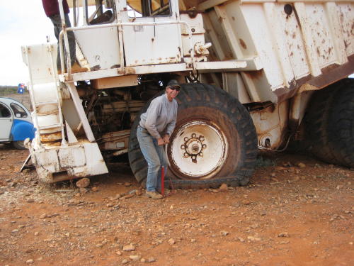

Whatever size tyres you choose, remember to take a light hand operated tyre pump. Doesn't take much space and pumps up a 2CV tyre very quickly.
It is a bit slower on non-2CV tyres.
Daffy Duck

You are so right, and i don't think you will be finished for the first ½ hour with the tyre at your photo :D
